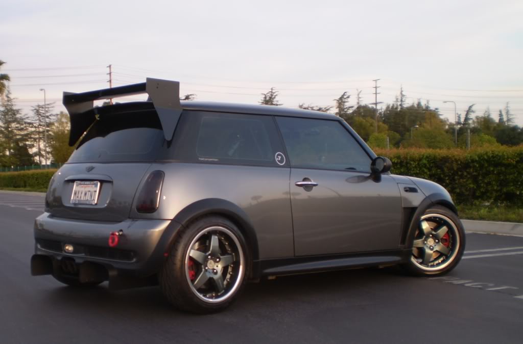

I have run both and I prefer the 45 series for a couple of reasons .
They ride softer do to the extra volume.
They fill the fender well better which gives the appearance of being lower when the car is actually higher off the ground by a minimal amount when compared to 40 series.
Better rim protection when encountering road hazards such as pot holes.
Easier entry and exit from steep driveways etc.
Randy
M7 Tuning
First two photos is with my track wheels and 40 series . The rest are with my 45 series sets.

Randy, is your car lowered in any of the photos? I think I prefer the look of the 45s as well.
Yes I am lowered by 1.3 inches front and rear .
