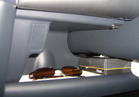

Abuzavi, your charity project for Wounded Warriors was brilliant! My parcel shelf came today, was installed in 20 minutes or so (would have been more like 10 if the second screw wasn't so stubborn about lining up with the hole... ) and I LOVE IT! I included a personal note to the Chaplain in Landstuhl along with my check, praising their work. You are to be commended for following through on such an inspired plan. Perhaps there are other MINI goodies in Germany that could lend themselves to a similar undertaking...?
Thank you so much for all the effort you took to buy, pack (good recycle of old stereo component box) and ship. And thank your daughter for the lovely art work on the carton's wrapping.
Attached are a couple of pics of the newly installed shelf. I've already put it to great use and highly recommend it to all week 36ers! This is how the MINIs should have been configured in the first place. I lined it with some carpet "no-skid" rubber backing, lightly tacked into place with two small corner pieces of double stick tape. No matter how twisty I drive, everything stays put!

I'm glad the stuff arrived, that it arrived intact, and that you found it that easy to install.
My daughter had a ball with the art work. I thought we were not going to make it to the post office that day, because she was so intent with her drawings. I can't remember how decorated your box was -- some had just a little bit, but two of them were completely covered in art work. She was in her own little world!
Which book did you get? One was the '07 model booklet, and the other was the extra merchandising stuff (t-shirts and the like). If you got the latter, maybe there's something in there we can use for a W3606 souvenir or something.
Oh, and my son had really, really wanted to include a bag of Gummi bears in each box. We made a trip a few weeks ago to Nurnburg, and I had brought along two bags, hiding them (I thought) on the parcel shelf. It was right after I'd installed the shelf, so the kids didn't know the shelf was even there. They spotted those Gummis, though -- right away! They call it the Gummi shelf -- we ate one bag, but the other bag remains there, just waiting for our next adventure weekend.
So, if you want to embrace your car's German heritage (it is a BMW, after all), I'd recommend Gummi cherries or some traditional Gummi bears!

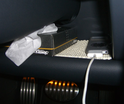

I pulled out the OEM iPod adapter, and installed the DICE. Much, much better. Need to figure out how best to configure the DICE -- I want song name information to display on the radio, but not also on the nav screen.
Nonetheless, it's a marked improvement. I also had to drop the $ for a new iPod -- my iPod Mini has crapped out on me, despite my best efforts to put the paddles to it and keep it going. Too many miles running, I suppose. Bought a 2 GB Nano.
So, anyone interested in buying an OEM iPod adapter? I'd advice against it, but I'll sell you mine. Make me an offer.

Here's the link to DICE at EAS. I bought mine from them for two reasons:
1. They totally rock here at NAM. They field questions and serve up good, useful answers.
2. They'll ship to APO addresses. They website won't, but when I asked about it, we did it through Paypal. Very, very cool.
You can read up on the DICE, here. Don't bother having the dealer do the install. I kid you not -- my 8 year could have done this install. Lotz of photos here.
Literally, it is:
Oh, and Torx. I bought a screw driver set (one handle, lots of bits) from my local ACE Hardware / Yardbirds / Home Depot type place, for all of about $10. Had all of the Torx sizes included. Used it on the Mini, used them to follow other DIY instuctions from the web to replace a failing hard drive on a computer (Mac laptop). Was a very tiny investment, but has paid off huge -- I've been in and out of the Mini radio probably 3 or 4 times now, instead of having to pay someone else to do it.
If you don't believe me that you can do this instead of having your BMW guy do it, I'll do it again and send photos of every step along the way. It's waaaaaay too easy to do yourself.
Now, I do need to add that if you already have the OEM iPod adapter in, there's one minor complication: you have to move three wires back. Totally do-able. I've got some related photos up here, where I was tackling a NAV voice problem.
To gut out the OEM iPod adapter, you'll be moving three wires from a seperated clip, back in with the rest of the wiring harness. On he wire harness end, there's this big clip thing -- it's looks like this (ignore the red arrow)
On the other side of it, you'll have to remove a blue plug -- it unclips from the middle, pulling the tab towards the itself, and then it slides out. Then you use something pointy (I use my smallest Torx bit) to push in the snap poitions on the end of the wire you need to remove, and out they come. They gets the horrible OEM iPod wires out of this clip.
You then do the same for the original wiring harness wires, which are in a special clip. After that, you slide them into their original place in this big, fat, square clip.
I did them one at a time -- the brown one from the small clip, the brown one from the big clip, then putting the brown one in the big clip. Colors all match. Very easy. Sound scary, but isn't. Like removing the Borg.
