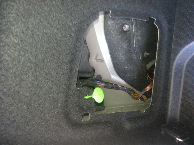

Hmmm. I removed the vent looking thing from the driver's side and I only see this big collection of wires. Are these the wires that I use or are the 2 wires somewhere else? Thanks!

see attached photo for details on finding the wires
