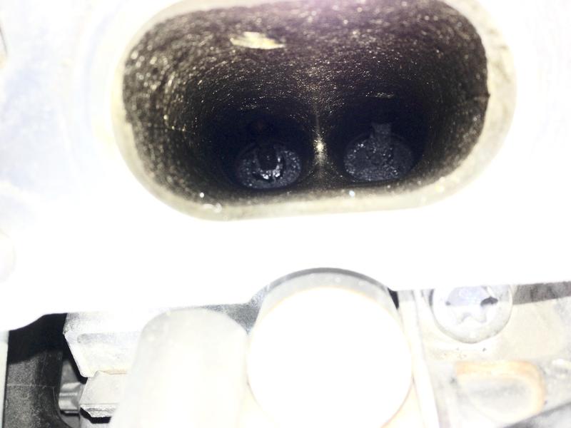

3 of the 4 valves look like the grey (left picture) and 1 closest to the driver side looks oilily and black (right picture). Does this mean there is a leak or this cylinder not firing or to rich of fuel?
Attached Thumbnails Cylinder Not Firing?-fullsizerender.jpg   Cylinder Not Firing?-fullsizerender-1.jpg

the one pictured on the right looks like pretty typical carbon build up as a result of direct injection from what i've seen. the ashier looking ones, i'd assume it's probably carbon as well but i'm not sure why these 3 cylinders look different.
... i lost interest in installing a catch can 6 months after i got my CM.. maybe i should look into it again.
what happened to make you take these photos ?
year, model and miles of your CM ?

2011 All4 83K replaced the Ignition Coils, Injectors to finally replace the High Pressure Fuel Pump and then the car said the Crank Position Sensor is bad. So I was on the hunt to look for this sensor knowing it was bottom part of the engine by the firewall. So started jumping into the engine and found that its by the transfer case and have to raise the car. Always wanted to see inside the engine and haven't purchased a USB Endoscope yet so I took pictures looking into the engine. Now I'm thinking it's time to get rid of the car because of this one valve.

carbon build up is common in minis there's lotsa threads about it and for 83k miles it actually doesn't seem that bad... in the first 3 cylinders. even at that you can google images of minis with 100k miles and much worse build.

My only concern is cylinder 4 if that is the correct number for it, the dark oilly one.

I wonder if that one cylinder is somehow closer to the PCV system so it's pulling in most of the oil? I'm curious what mine look like. I know the N18s are supposed to be better when it comes to carbon buildup on the intake valves.

Since these are direct injection engines (directly into the cylinders), the fuel injection cleaner won't ever see the intake valves to clean them. Might clean up the piston tops a little...
