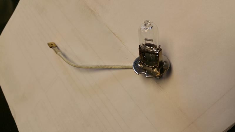

Has anyone replaced the mini fog light bulb for a LED
Has anyone replaced the mini light bulbs for LED's. I believe the current bulb is a 12v 55W H3....Looking for a better sight as well as look to go with the mini driving lights...Thanks!

I've seen H3 LED bulb replacements, but in my experience none of them have come remotely close to the incandescent's light output and range. They'll have the look, but are not really functional. A simple bulb replacement just won't cut it if you're looking to still use them.
If you're looking to go LED though, the new LED driving lights are coming soon and will be retrofittable to those who already have driving lights.
The factory LED fog lights are pretty bright, as bright as any H3 incandescent bulb I would say and it match xenon lights nicely.

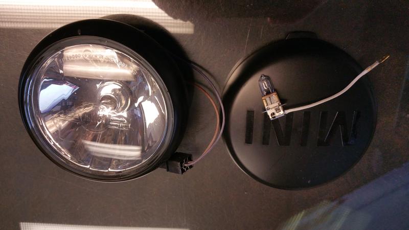

I hope I'm not confusing the different type of lights...The lights I'm referring to are the ones pictured in my first post. Bought separately through Mini and mounted on brackets attached through the grill... The daytime driving lights i've converted over to the newer Mini style LED's and look great.
This is the bulb that comes standard in the light and am looking to change the pair over to LED's if possible. Wondering if anyone has and if so...style & size ?

Yes, the factory LED lights are plenty bright, but the LEDs in those are integrated into an assembly and have their own heat sink and such surrounding it.
I meant to say that a straight bulb swap, while possible, would lead to disappointing results, especially when comparing them to a factory LED light.
I found these on eBay that would be cheap enough to try, I have similar ones as reverse lights, but they will not match the light output of the factory LED or incandescent lights.
http://www.ebay.com/itm/H3-80W-CREE-Super-Bright-LED-White-Fog-Tail-Turn-DRL-Head-Car-Light-Lamp-Bulb-/261674149472?hash=item3cecfea660&vxp=mtr
Try them out - $20 for two isn't too bad of a hit and if you need something brighter, get the MINI factory LED driving lights when they come out.

The aftermarket H3 LED bulb will not be as bright as the halogen or the oem LED foglights. It might also trigger a bulb out warning as well unless you use resisters or error free bulb.

I've decided to replace the complete light package over to the LED's...
placed the order with ECS Tuning....should see them later this week.
