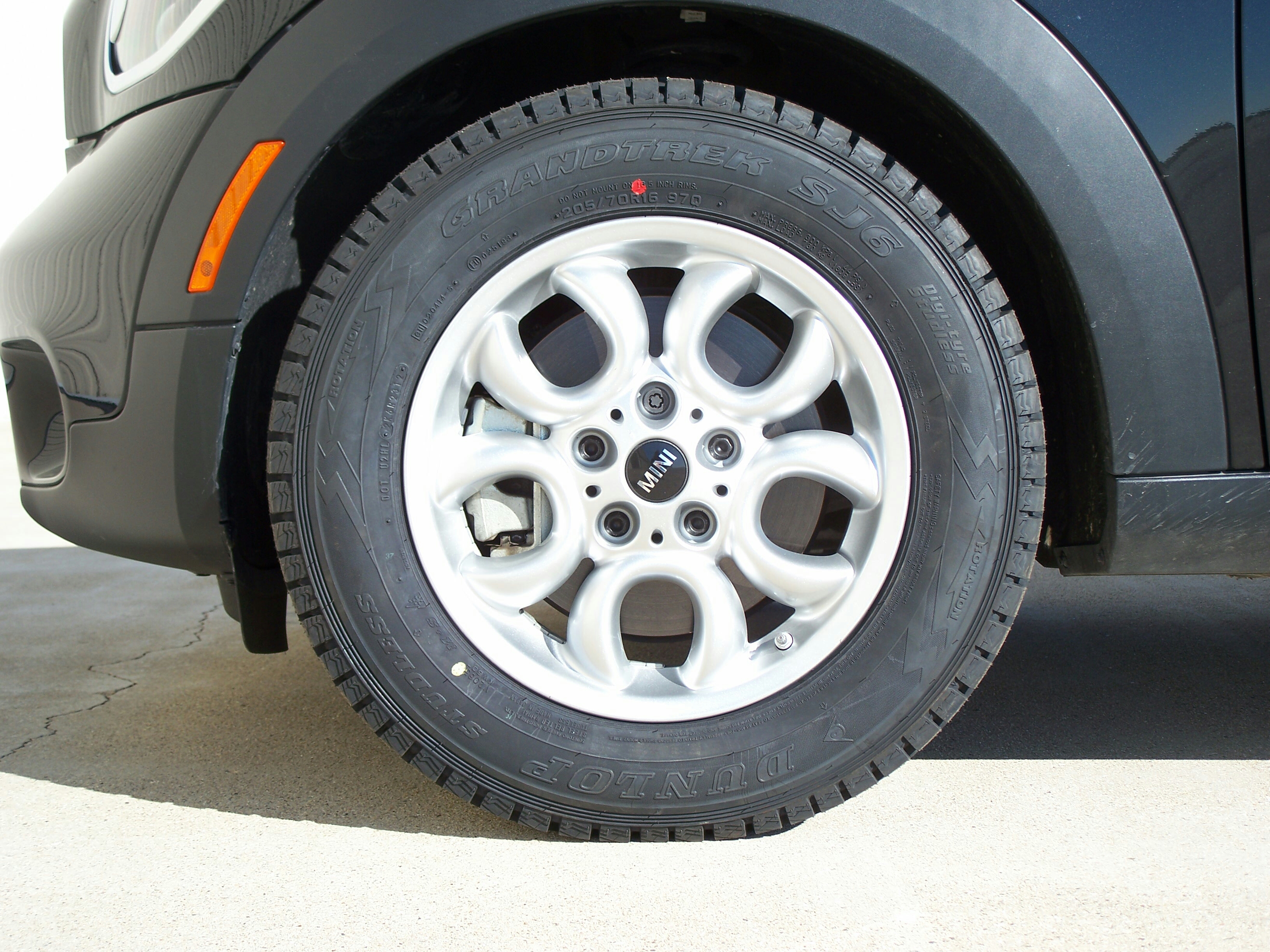

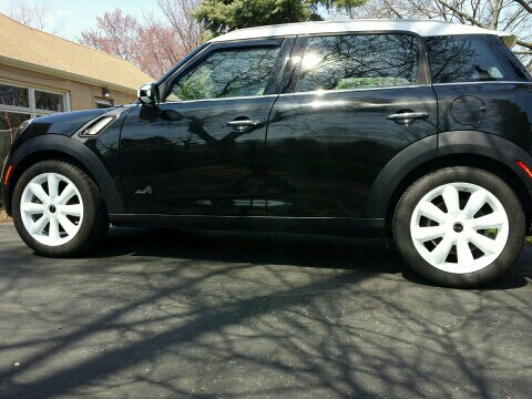

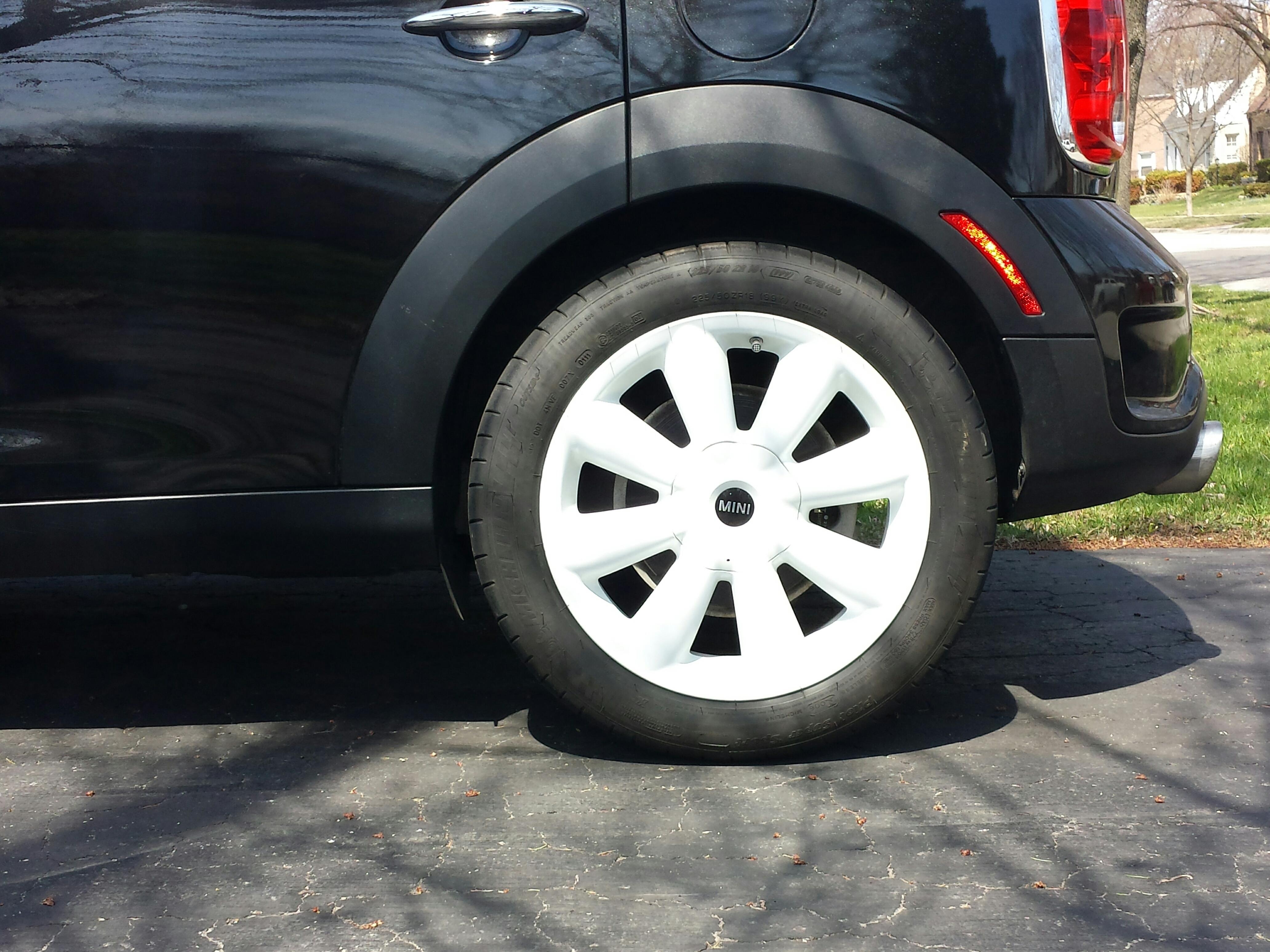

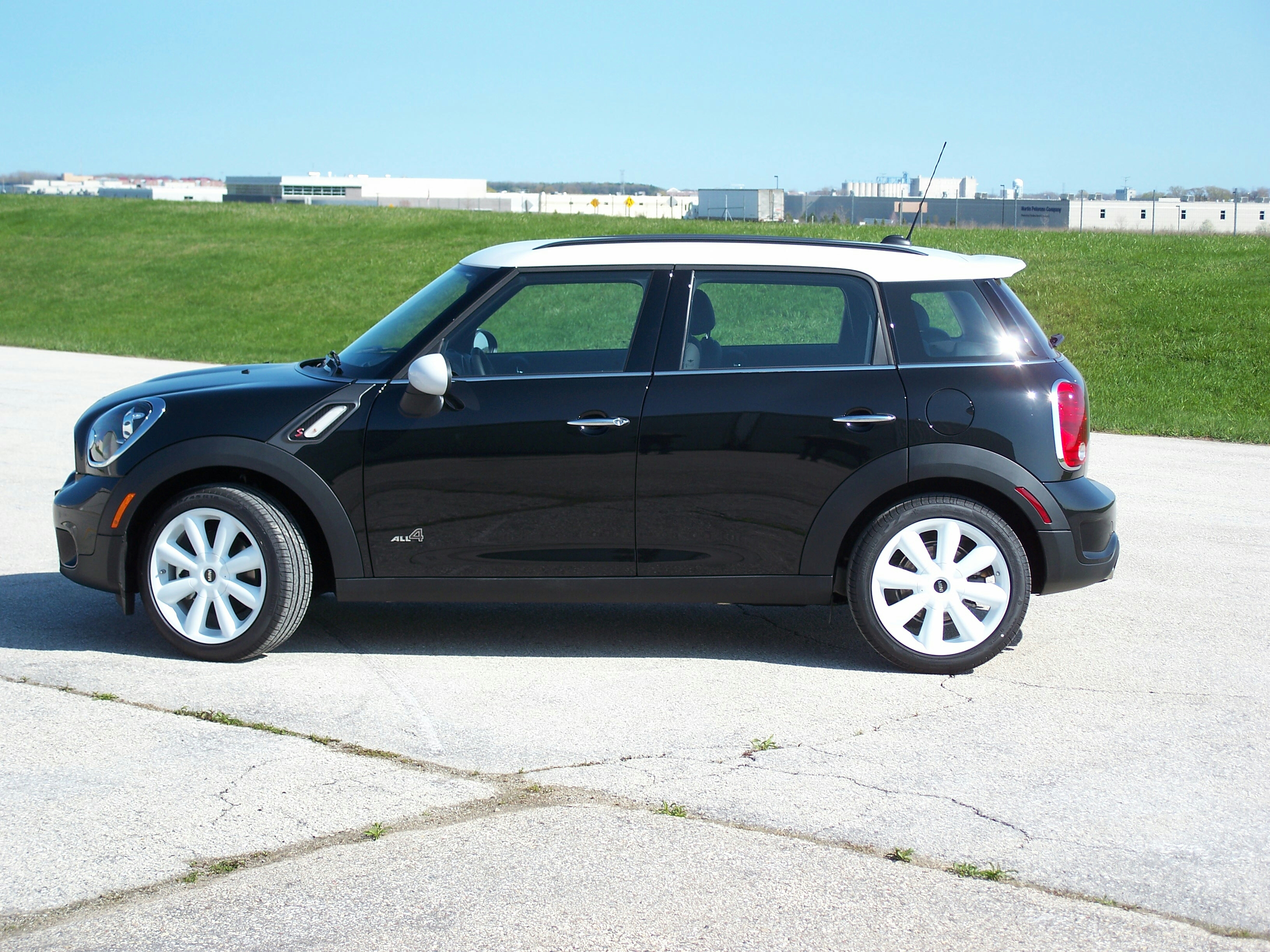

left to right
225/50R18
205/70R16
225/45R18
no rubbing at all, been running the larger sizes over 4 years now
Attached Thumbnails 215/60r17-1406536470793.jpg   215/60r17-100_1918.jpg   215/60r17-100_1789.jpg.jpeg

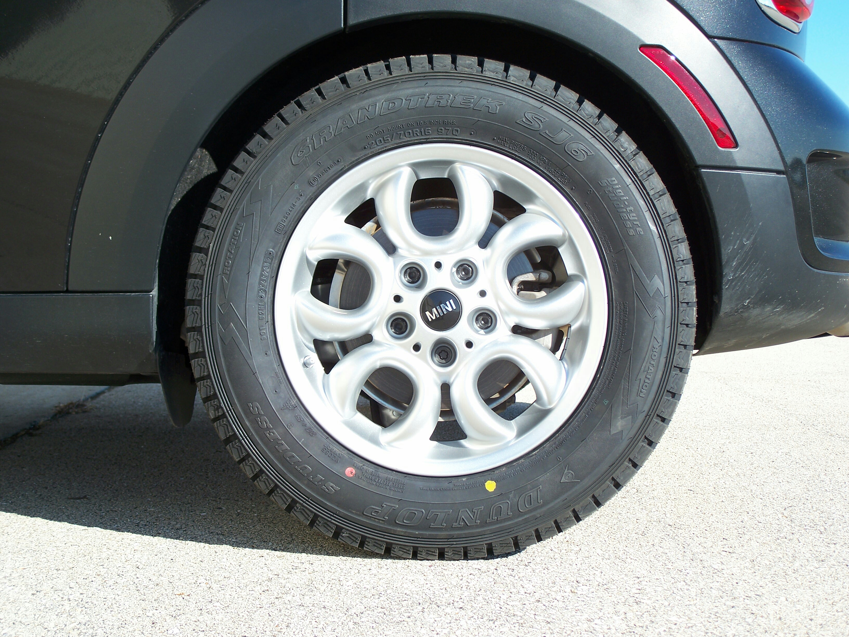

just found there closeups ... thiught i had deleted them
205/70R16 and 225/50R18
Attached Thumbnails 215/60r17-100_1920.jpg   215/60r17-100_1922.jpg   215/60r17-20140420_132145.jpg   215/60r17-20140420_132130.jpg
