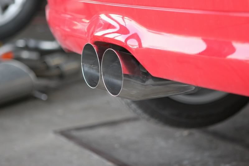

And, last but not least, the tips fit absolutely flawless. Thumbs up to Quicksilver on the flawless design!!!

Looks good.
Can you make a pic from the front of the tips?
I want to know how it looks like inside the tips

Originally Posted by Maaij
Looks good.
I sure will.
