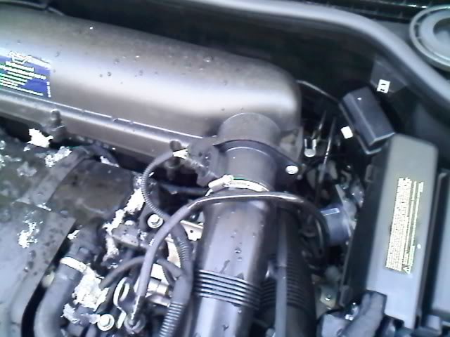

Im guna try to install my bsh cc on my 2011 MCS. The only thing I seeis that the hose from the manifold is coming off facing the front of the car rather than to the right facing the wheel.
see it on the left next to the little bit of snow that came through my hood scoop lol.
