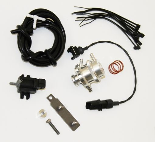

Ordered the Forge valve kit for the N18 since the stock valve is only rated to 1bar... And because I just like changing things. Haha.
Next on the power mods list, I think, is a hybrid turbo and exhaust manifold.
Also probably gonna drop cash on some suspension goodies soon.
Trying to be the craziest Mini in the neighborhood is an expensive hobby!
Best way to eliminate the muffler thingy without spending a lot of money on a boost tube haha,
did the same thing myself.

I got the Forge N18 BOV (Recirculating) kit installed yesterday. Haven't had much time to drive it yet, but in the few miles I put on it, I can say WOW is it quiet compared to the stock valve.
Even with my open air box NM Intake, it's barely noticeable with the windows up and the tone of the sounds is more of a "tsschewww" sound now. My only explanation for this is the Forge valve must flow a lot better when opened and therefore is making less noise.
Install was pretty straight forward. Standard pains of getting to the DV area but the vacuum hose routing and solenoid mounting was a breeze.
I only had one hiccup. I dropped a DV bolt and the car ate it. I looked for the thing for over and hour and couldn't find it. For the time being, I have an equal threaded bolt in its place with a couple small washers to keep it from bottoming out in the turbo housing, but I need to get a new bolt (or a whole new set just to keep around in case).
I found them on Sewell's website, but they're 6.50 each and shipping is like 12 dollars (ridiculous). Does anyone know if the dealer stocks these or if there is an easier place to get some from?
