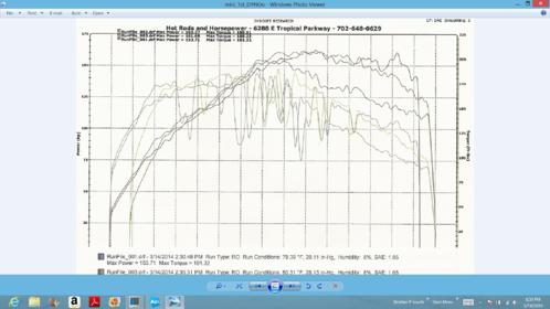

Went and took care of my baseline dyno today.... so now its time to start playing around.
The TQ was swinging around and was wondering if anyone has seen this before. The car ran fine on the dyno...
The lower pull was sport button off....

What do you mean by torque swinging?
I was interested that you actually saw a different power reading without sport button. I thought sport button only changed the throttle ratio map (no data here, just opinion.. maybe it changes more!).
I ran my car up as standard and didn't experience the 'messy' torque graph you are describing but we dont run the rollers on an acceleration test, we run it on a loaded test where it is set to hold each 500rpm increment and stabilised readings are taken.

if you look at the picture I posted it shows the TQ swinging around a lot through out the dyno pull.
this was just a dyno on rollers with a 4th gear pull from about 2500 rpm
the sport button adds about 3 psi of boast and more aggressive timing curve.
I see 15 psi with sport button off
18 psi with sport button on

There is a smoothing setting on the dyno software, I think that might need to be changed, I can not see it on your photo as its too small.

The chart posted is too low resolution to really see, but typically that sort of torque moment is associated with a poorly placed tach signal. e.g a recording error.

I will look into doing a better post of the picture. The tool bar does not seam to give you much help to install pics with size options.
good idea on checking the tach connection --
Im starting to put parts on it so before I put the exhaust on im going to do another dyno run just to see if anything changes after a few normal aftermarkets are thrown at it

How can you make any conclusions with such a sh1tty plot from the dyno operator? For God's sake turn on data smoothing!
