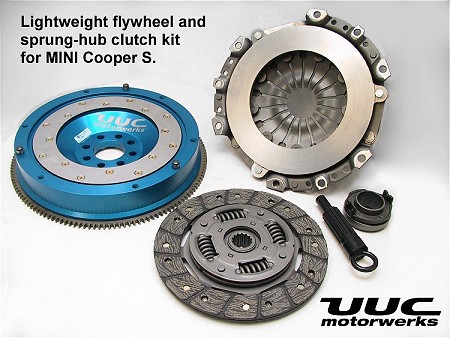

Previous posts on other threads indicate that UUC Motorwerks rebadges Fidanza flywheels and Spec clutches - though this picture and actually having the parts in my hands might indicate otherwise....
PICTURE: https://secure1.nexternal.com/uuc/im...CH_KIT_450.jpg
From THIS page:
https://secure1.nexternal.com/shared...&RowID=272&All
Eh, I'll give them the benefit of the doubt that they made the kit themselves... If they didn't, they sure went to some length to laser engrave their logo on the flywheel, so who knows....
From THIS page:
