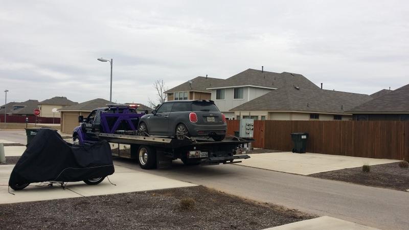

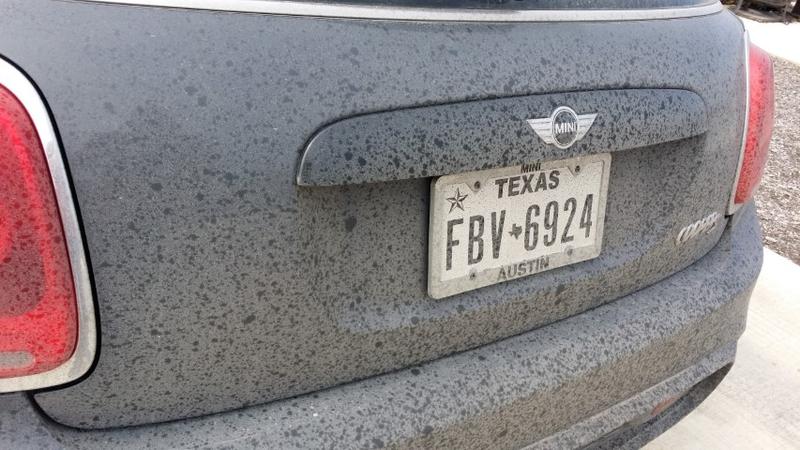

I got lucky today... :(
https://www.northamericanmotoring.co...not-happy.html
2014 S with 2600 miles... Bought it about 6 weeks ago...
Attached Thumbnails OIL Filter Housing Failures-20150307_140903s.jpg   OIL Filter Housing Failures-20150307_141038s.jpg   OIL Filter Housing Failures-20150307_152731s.jpg
