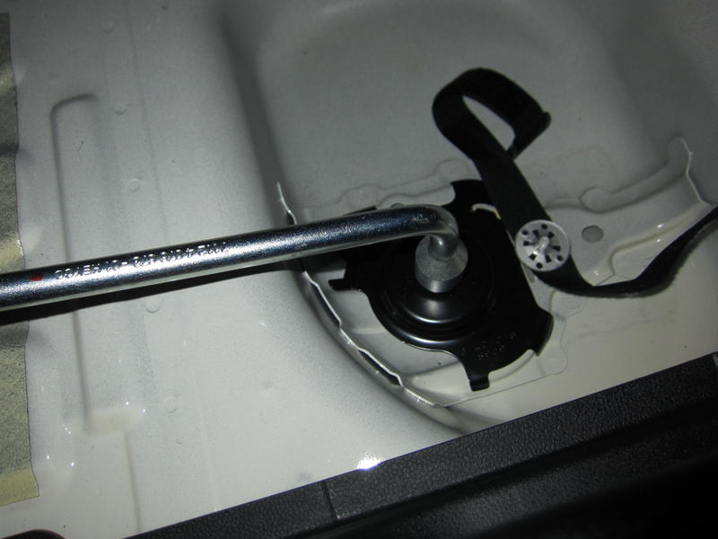

Our first full day with our new 2015 F56 Justa. In another thread I posted about the spare and that I thought the lug wrench did not fit the bolt you need to get the spare tire down. So tonight I gave it another try and it does indeed work. So I thought I'd just go ahead and lower the spare and figure out how to do it rather than on the side of the road somewhere. Plus there are a large number of questions on the spare so I thought I'd take pics of it going back up.
The bottom line is on the Justa there is a spare no matter what wheels you have. We have the 17" wheels and for some reason they are not Run-Flats. So I wanted to know how to use the spare. It is a do-nut spare and might not handle well on the car with 17" on the other three corners but it just has to get the car to a tire place.
So here are some pics and instructions on how to get the spare down.
1) Lift up the bottom most panel in the boot and you will see the jack, lug wrench, tow hook tool kit in a little styrofoam holder. It is held in place by a Velcro strap. Un do the strap and wiggle the kit out. It is snug.
2) Under the kit is a plate that is securing the spare tire and a nut that snugs it all up. The plate serves double duty as a tool.
3) Use the Lug wrench to loosen the nut. You can't swing all the way around, but work the nut off completely. The spare tire won't drop yet, just undo the bolt.
Attached Thumbnails Yes There is a Spare, and How to Get it Down-img_5873.jpg   Yes There is a Spare, and How to Get it Down-img_5872.jpg   Yes There is a Spare, and How to Get it Down-img_5871.jpg

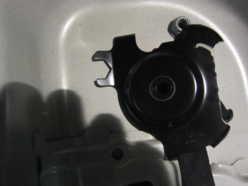

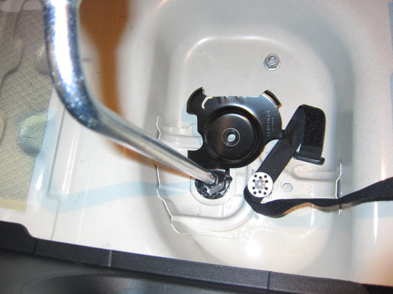

Dropping the Spare Part 2
4) Once you remove the nut the plate comes off. If you notice there is an open end wrench stamped in the edge of this plate. This is needed to rotate the plastic (yes plastic) part that is keeping the spare tire from dropping. It needs to be rotated counter clockwise into the unlock position (step 6).
5) Now that the plate is off, take the shaft end of the Lug Wrench and screw it down on the shaft of the bolt. It is how you will lower the spare down. As soon as you release it using the plate you removed.
6) This picture is not the best but... While holding the lug wrench that is screwed onto the shaft of the bolt... use the open end wrench to rotate the plastic part to the left. There is a corresponding 'nut' molded into the plastic. But this is not the most robust design. The plastic part must be rotated 10-20 degrees counter-clockwise so that the D shaped plastic part aligns with the D shaped hole in the sheet metal. Once you are able to rotate this plastic part the tire will drop so hold onto that Lug wrench, you are holding up the spare.
Attached Thumbnails Yes There is a Spare, and How to Get it Down-img_5869.jpg   Yes There is a Spare, and How to Get it Down-img_5867.jpg   Yes There is a Spare, and How to Get it Down-img_5868.jpg

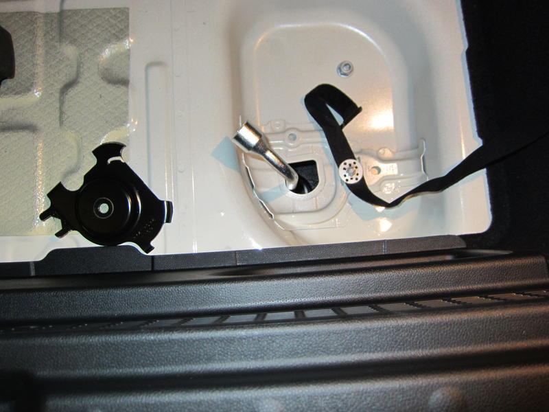

Dropping the Spare Part 3
7) Now that the D shape of the plastic part lines up with the D in the floor of the trunk the spare tire will drop. All the weight of the spare will be on the lug wrench. Use the lug wrench to drop it down to the ground. It is not that heavy.
8) You'll have to unscrew the lug wrench and slide the spare out. I didn't do this, didn't want to scratch the plastic on the garage floor. I should have use my little shop dolly but didn't think about it at the time.
Reverse the process to re-install the spare. It is a little tough to hold the spare up with one hand and rotate the plastic part with the other to lock it in. Once it is locked in you can put the metal part back on and tighten the nut down. It is the nut and plate that take the weight of the tire. You can over tighten this, don't over do it. I might check this nut once a year to make sure it is not backing out. And hopefully there will not be water getting into this area in the bottom of the boot.
Anyway, this is the spare. You do have access to the fill valve while the spare is stowed. My guess is that there will be a lot of flat spare tires on this car. This do nut spare needs to be at 60 PSI. Who will actually pump this up? Maybe I need to get the service department to put nitrogen in it lol.
The tool kit is pretty minimal. The jack is about the smallest one I've seen and the lug wrench will have a hard time getting 101 ft-lb lug nuts off. But in a bind you could probably make it work. I wife certainly can't.
My MA told me that even these do-nut spares are going to be eliminated in the near future. This will require run-flats as standard on every size.
Hope this helps...
Attached Thumbnails Yes There is a Spare, and How to Get it Down-img_5866.jpg   Yes There is a Spare, and How to Get it Down-img_5865.jpg   Yes There is a Spare, and How to Get it Down-img_5868_cropped.jpg
