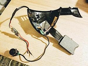

I was pretty discouraged but then I found the Mobius Action Cam, which is a nice little camera that is marketed kinda-sorta as a goPro alternative, but one that lots of people use as a dashcam. It is pretty darn small, and has a fair amount of accessories and stuff that let you customize your setup.
It would probably have been fine to just mount it as-is somewhere on my windshield, but I wanted to not be able to see it at all while driving. The mobius can be easily taken apart, and you can move the lens away from the body - as you can see here:

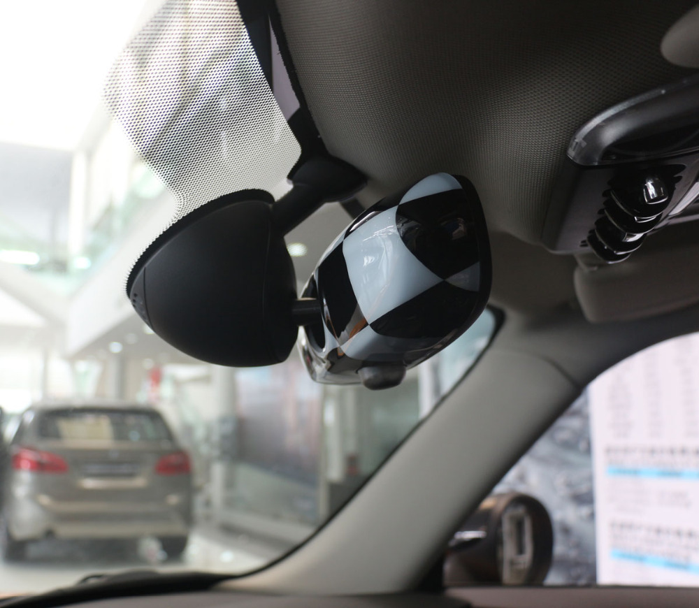

My plan was to place the guts of the dash cam inside the bulbous plastic surround of the rain sensor and windshield attachment area as seen in this photo (directly behind the mirror). BTW this is not my photo/car, it was taken from google images.
That plastic surround is made up of two halves that are fairly easy to pry apart, and there is a fair amount of room in there.

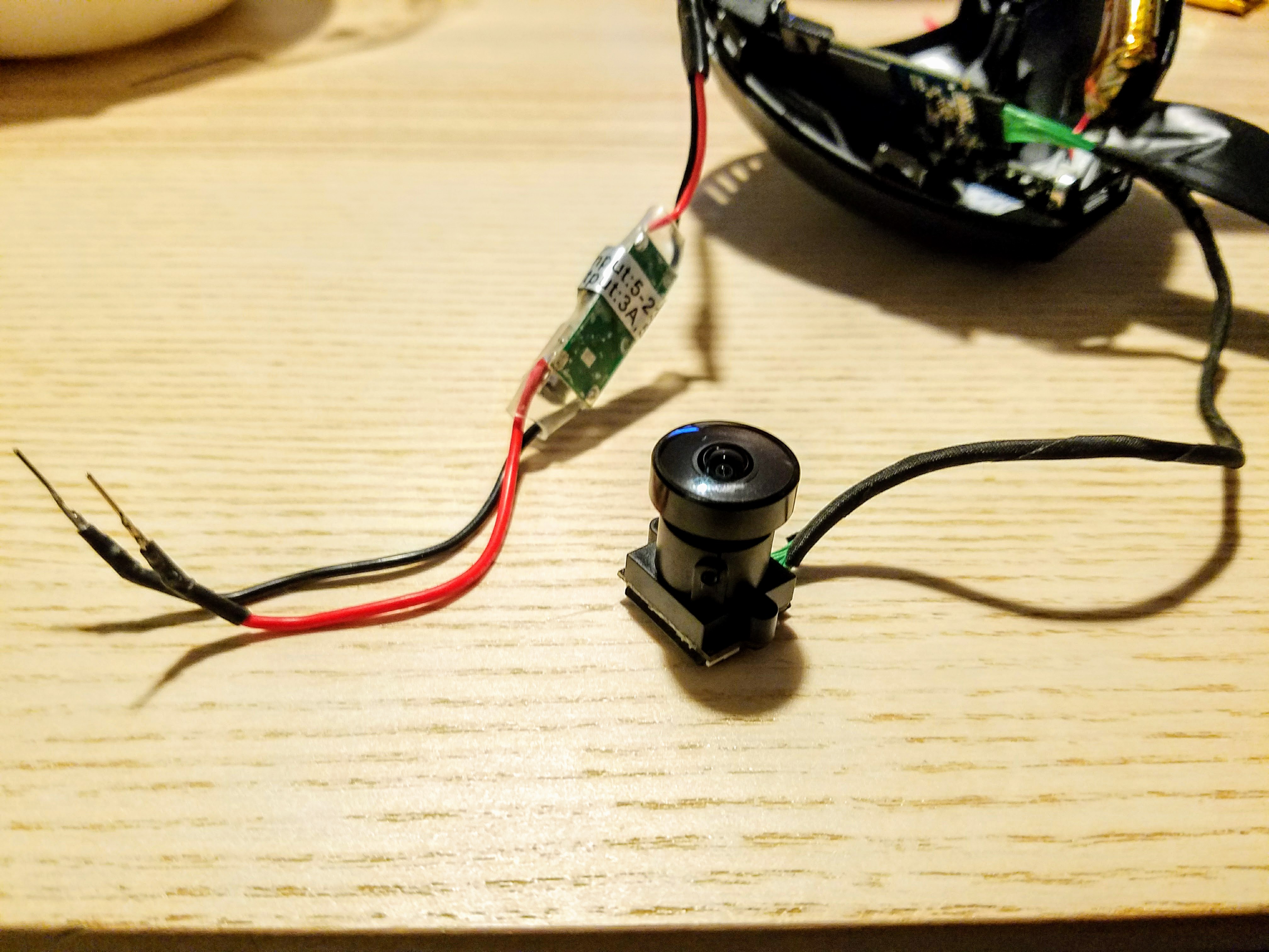

For power, I tapped into the circuit that (I'm pretty sure) powers the rain sensor. I measured 12.5 ish volts on that circuit, so I spliced a 5v voltage regulator into the camera's USB cable. I literally just shoved the power/ground leads into their respective slots in the connector near the rain sensor and it works great. Here is the regulator with the optional wide angle lens:
Like I mentioned before, I wanted easy access to the SD card so I bought a microSD extension cable. It goes from microSD (What mobius takes) to standard SD (which is a little easier to grab from behind the mirror without looking). The ribbon cable was like 20" long so I had to fold it over on itself several times and tape it down and out of the way.

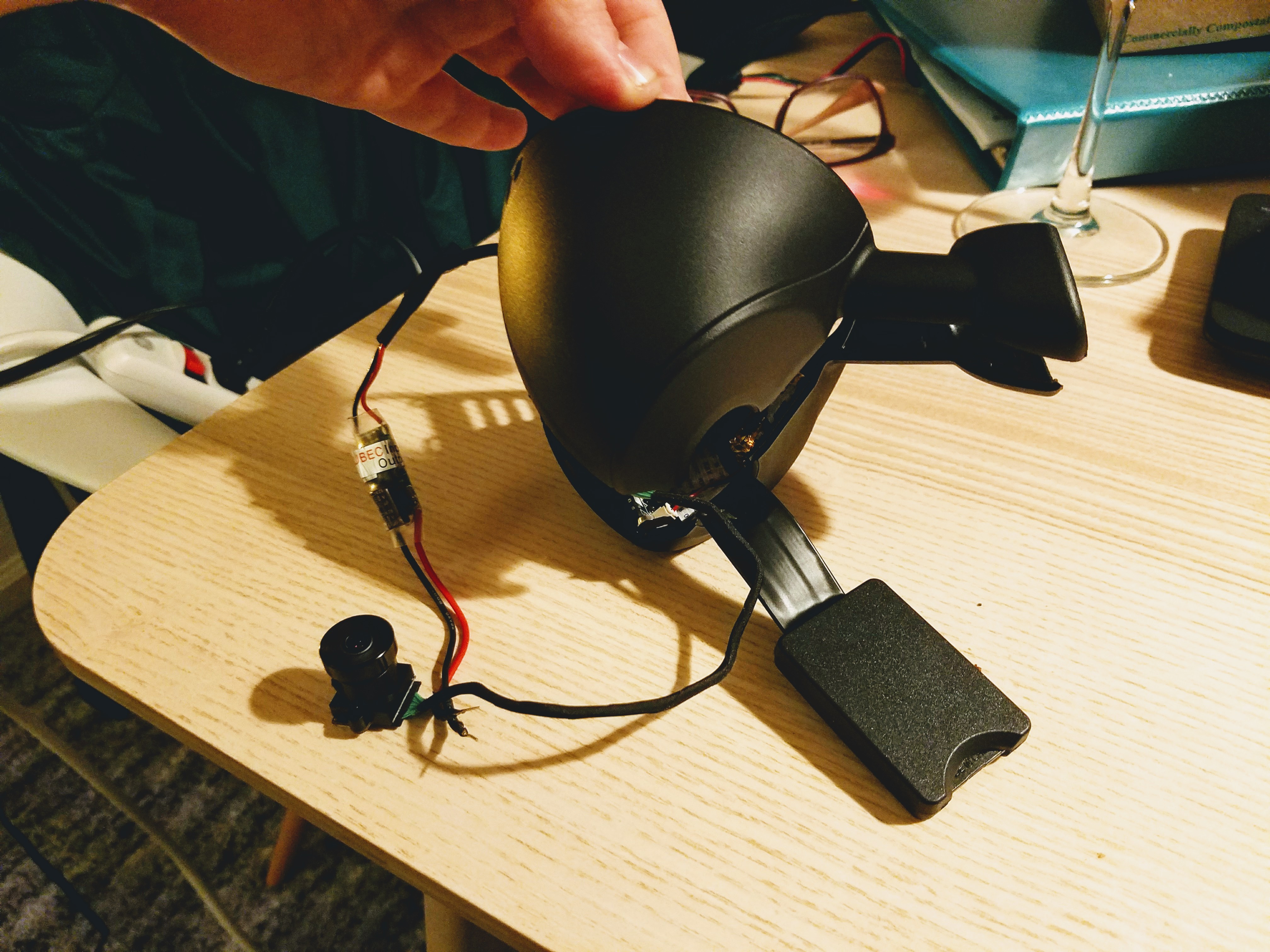

It ended up being a little crowded in there, but it all fit. This image shows the circuit board (inside plastic housing on left), capacitor (inside plastic housing on right), excess SD extension cable (inside plastic housing in center), voltage regulator (left), SD card adapter (right), and wide angle lens (bottom left)
Here is a closer view:
Here I am trying to make sure that the other half of the plastic surround will snap in smoothly without anything getting in the way:

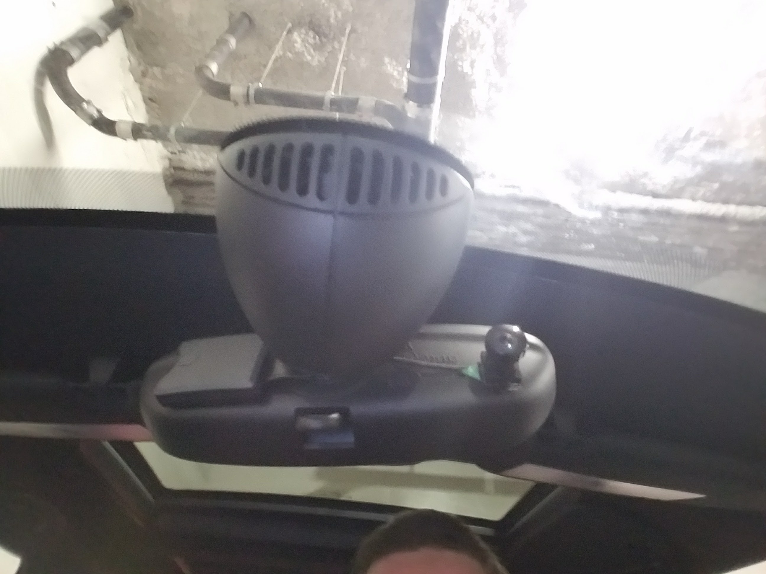

Here are a few pictures of everything installed. The SD card extension is a little bulky, but it can’t be seen my the driver (and not really by the passenger either). It is also pretty hard to see from outside of the car unless you are specifically looking for it.
