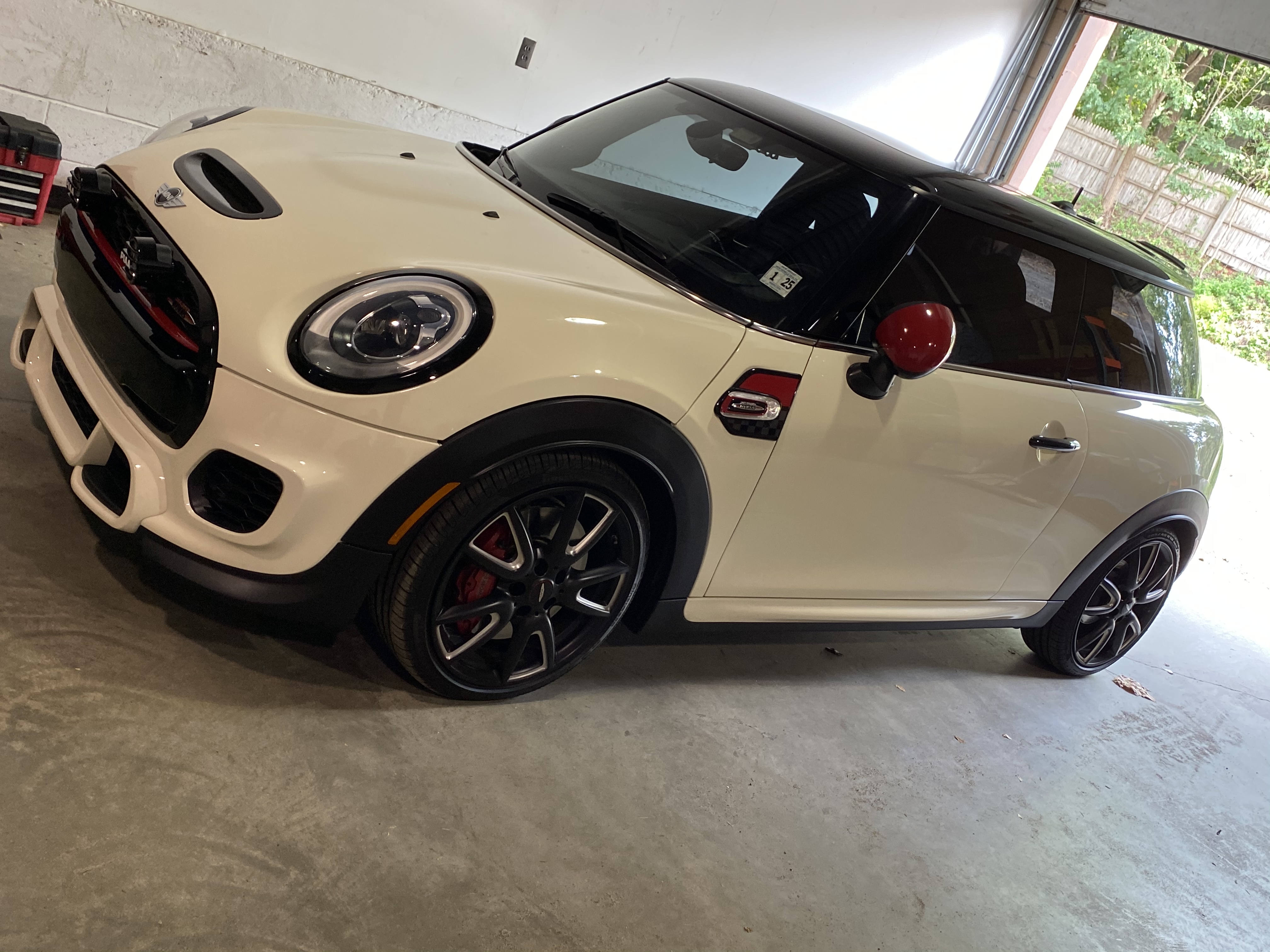

Pics of the mirrors folded in after locking and of the lights working with zero issues or warning lights. Thanks again “CodeMyCar”!! Saved the day!
