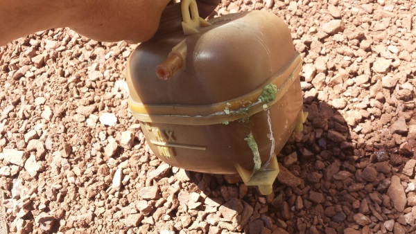

Whoa! The coolant bottle on my R53 is the same color as your old one, but not showing any signs of leaking. Were these bottles really that white when the cars were new, or was there a change in the bottle material over the years?
Originally Posted by E-dot
Just a sliiiight difference. This was definitely a ticking timebomb.
That is a pretty white tank! HERE are what the Genuine and Behr tank colors look like, little brown in color. Maybe it's a different manufacture?
Here is mine before and after... If your tank is this color, I would swap it! I waited until I visually saw the tank leaking in front. When I removed the old unit, 75% of the leak was in back and unseen.
Leaking in back...
