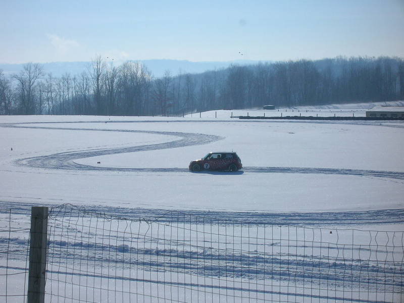

Oh good golly folks. On winter tires the Mini is an extremely competent winter vehicle as cars go. All-seasons, with all due respect, are NOT winter tires. Some all-seasons perform less worse than others, however.
At this point, several people will chime in with arguments beginning with "I live in (insert wintry city here) and I've only driven on (insert all-season tire name here) and I've never/rarely/not-very-often had any problems except in (insert nasty winter storm here) where (insert number of trees that fell and how long power was out)."
"In God we trust, all others bring data".
In PittStopMINI Club winter testing, identically-prepared Mini Coopers on the same ugly winter-conditions track with the same set of drivers, snow tires covered the course in ~30 seconds. The best driver on the best all-seasons could only manage about a 45 second run. Doesn't sound like much difference on a short course but that's a FIFTY PERCENT loss in traction. The loss in control from behind the wheel was very noticeable. The difference on ice was larger (we didn't measure that, however).
Winter tires work. Note, however, we're driving cars, and small ones with low ground clearance at that. If we expect to be able to go where a Subaru Outback on snows can go, we'll be disappointed. We will, however, outmaneuver most other vehicles when it comes to typical, packed/icy/slushy roads.

THEN come to Pittsburgh in February for our Wintry Driving Refresher winter-driving course... great big snowy fun. Pics from previous years...
