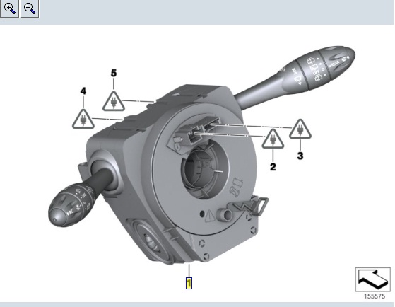

Last I checked it wasn't a matter of just adding the MFSW pods, the whole steering angle sensor aka: section behind the steering wheel had to be replaced as well. That alone is about an $600.00 part. And the one from the GP2 is without rain sensor, and only one made like that. Not sure why.
Similar part no. with rain sensor is: 61-31-9-253-770 SWITCH UNIT. But here may the problem. After installation, it has to be programmed to the car. This part may not program properly since it is not a part which was designed to be in the GP2.

Also from what I can tell, a MINI which comes from the factory w/o MFSW controls ( ala R56 and up )cannot be adapted to just have pods installed. BUT the replacement part switching unit above, say if you had to replace the factory one is MFSW compatable. At least reading the parts catalog crib notes from BMW this is whats indicated.

We've sold several of these kits and even did one this week. You will need our kit and then it will have to be coded after you install it, then retrofit code the rest of the car to make the cruise work. It only takes an hour to swap it all out, then time to code.
