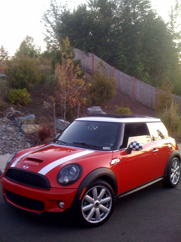

My joey mod
[IMG]file:///Users/DC/Desktop/mini.jpg[/IMG]
Thought I would share...easy great mod thanks!!!

d_m0906 - looks good!
