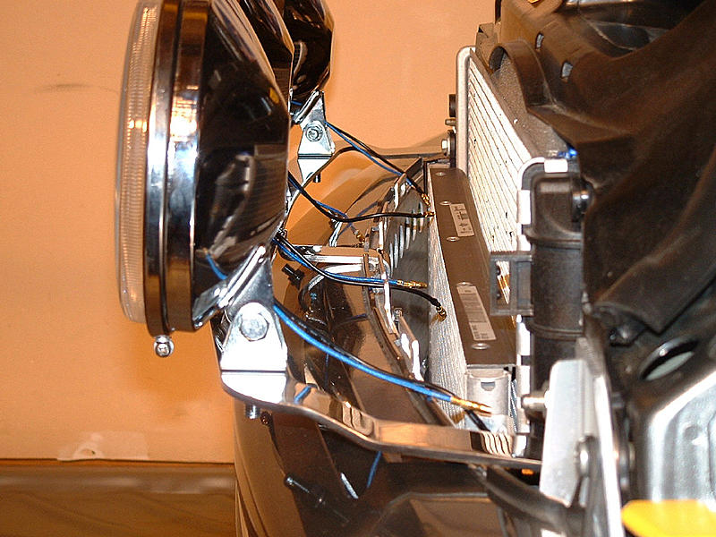

There is another light bracket that fits with no visable modifications if it needs to be removed in the future. See the attached photos. It is a very nice bracket.

Who makes that bracket? I like having my driving lights mounted high like that. What I'm using now has them lower than what's ideal.
