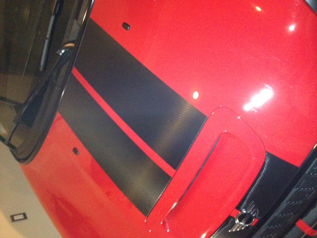

Has any done the carbon fiber vinyl as bonnet stripes?

I didn't do the stripes. Local pro installer did them.

Taz, that CF on your red mini looks good. Not sure how it would look on my BRG. ) Thanks for the photo.
