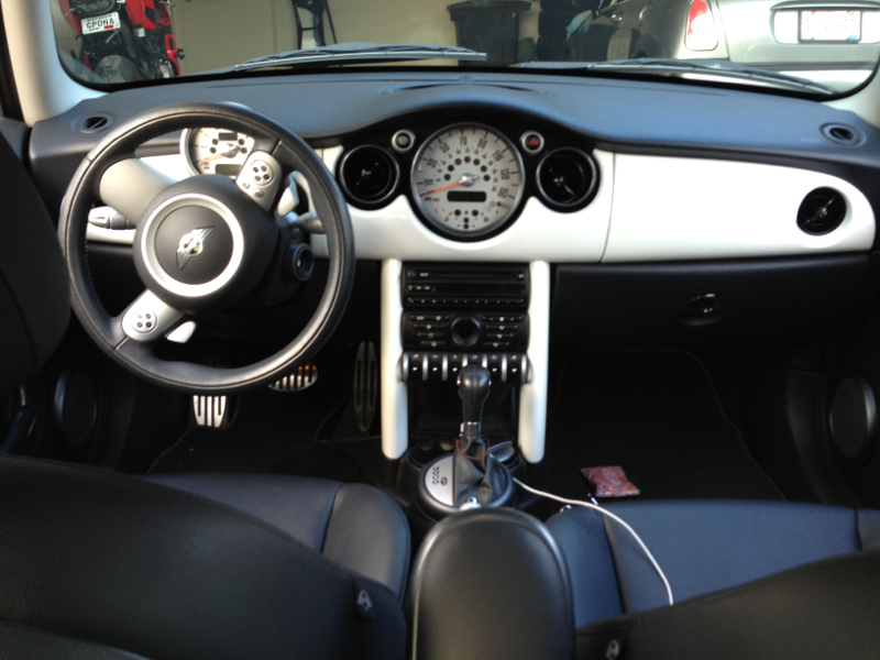

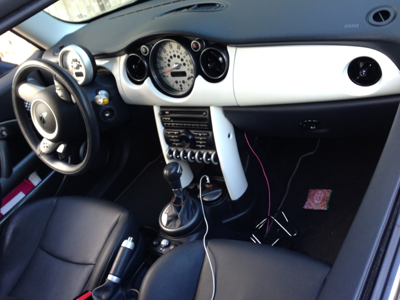

Just thought I'd share a few pictures of a few panels I painted. Used PlastiKote. Came out pretty good, but still have a few edges to touch up and smooth out.
Thoughts?

Looks great, nice job.

Looks fantastic. Doing the door panels too?

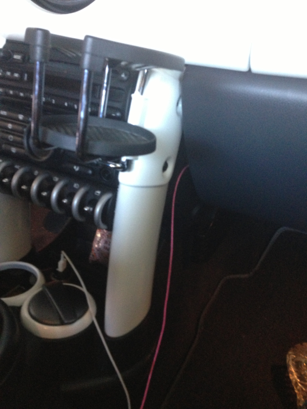

I just did the cup holder rings and the cup holder on the tube. I did scratch the paint a bit reinstalling the metal, but I really didn't spend much time on the cup holder plastic.

I like this idea a lot. Your work so far looks great, but i think tying in the light color in other spots would really bring it together. Nice job!

Looks good. What finish was on them before you started? Did you do any surface prep?

The panels were the anthracite colored ones, and this is where I made two mistakes that caused extra work. Now by no means do I own a body shop or tools to do body work, I just like DIY projects. I sanded the downtubes and primered them, 400 and 600 and then started spraying.
I only sanded the panels to break that glossy finish and didn't primer, think that the paint was going to stick fine.
That just cost me multiple coats. I'd spray two layers or twice, then sand the spots and kept repeating the process. I would really say that the paint did a lot of the work to. It stuck good.
I will be doing the steering wheel silver parts this weekend, and I would just say prep the surface by priming and then wetsand and dry with alcohol before respraying.
I hope this helps!
