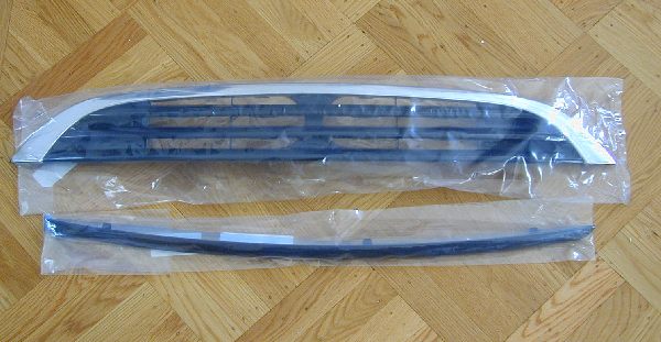

Here's an update on the OEM black grille.
At my last post, it was on backorder by MINIUSA and not yet released. It has been released and I just received one from Classic MINI. The complete grille assembly including chrome surround is $45.40 from Classic (MSRP $56.75). The black slat for the bumper grille is $13.52 (MSRP $16.90). This is quite a low cost for a dramatic change in appearance.
The bonnet grille should be quite easy to replace. Remove the flange nuts attaching the existing grill, pull off the entire grille, put the black grille in its place, and reattach with nuts. I also purchased extra nuts at 16 cents each, in case I damage some on removal. The grille is attached with 11 nuts.
Now I just need a car to put them on. It should arrive next week!
Here are the part numbers:
Bonnet grille 51-13-7-133-846
Flange nut for bonnet grille 07-13-1-509-597
Upper bumper grille slat 51-11-7-032-899
(edit: Classic MINI thought the following part was the adhesive tape that attaches the grille slat, but the slat has its own double-stick tape. I found it unnecessary to replace this piece, which is a trim strip that goes between the grilled slat and the chrome surround)
Trim strip for bumper grille 51-11-1-490-960
