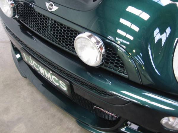

Mine does not fit flush but I did not trim the aero grille at all. I only removed the two upper outer tabs because they interferre with the factory slots. I cut new slots for the remaining tabs and snapped it in place
So. the tabs will engage with a firm push with no trimming. By trimming the grille down the self locking tab may be too long. requiring a pin or something to keep it tight against the bumper.
I dont think I have ever seen an aero grille on a std bumper sit completely flush like this on the aero bumper. I think the goal is to get that very minor 3/16 or 1/8 even all the way around the grille
Notice the DS in the pic doesnt quite sit as flush as the BRG
Attached Thumbnails lower aero grill not sitting flush-14639repaired_012.jpg   lower aero grill not sitting flush-dscn3468.jpg
