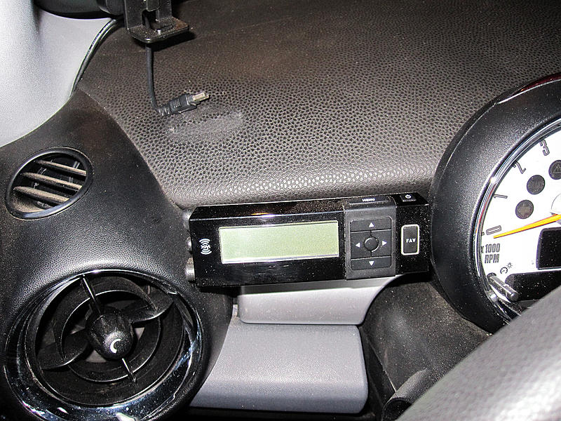

Simple XM Installation
I have an XM Sportscaster that I finally was able to cleanly install in a visible location to the left of the tach. Visibility is not fantastic but it is O.K. Here is what I did.
I purchased the straight arm GPS mount from GoMiniGo and attached the Sportscaster to the arm using a small screw (disassembled the Sportscaster....easy to do) through the rear of the Sportscaster and through the hole (used for mounting the "ball" socket) on the straight arm mount. I added a small piece of 3M foam adhesive to the opposite end of the Sportscaster for a solid connection.
I still have to route my wires permanently but that will not be a problem....just need the time to finish it. Currently, my antenna is attached to the center of the dashboard at the base of the windshield. Reception is O.K. with some occasional signal loss. I plan on tapping into the MINI's roof antenna eventually.
Here are a couple of photos of the installation.
Attached Thumbnails I just want a simple XM radio-xm-sportscaster-mini-install-03.jpg   I just want a simple XM radio-xm-sportscaster-mini-install-02.jpg
