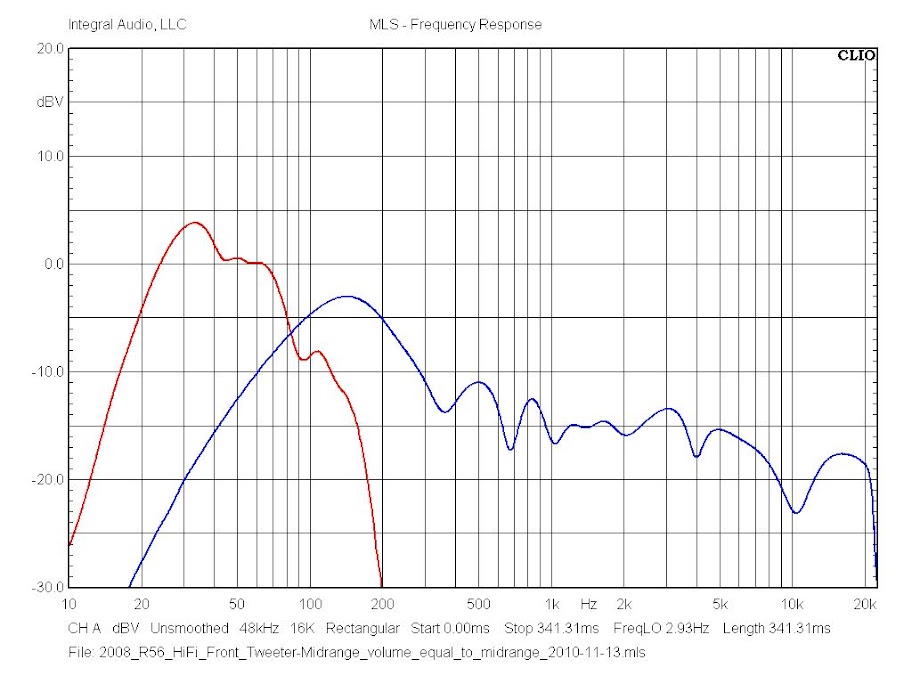

For anyone with the HiFi or new H/K systems, please note that you can't simply replace the existing speakers with Hertz, Focal, or virtually any other off-the-shelf 3-way system. Why? Because the HiFi amp has electronic crossovers and DSP shaping built into it. The front 6 speakers are powered by four channels of the amplifier - the 6" door woofer is one channel and only gets frequencies below 100Hz. The 3.5" door midrange and 25mm A-pillar tweeter share a channel that gets everything above 100Hz. The tweeter is protected from low frequencies below 8.5kHz by a very poor quality capacitor. BOTH of these front channels are heavily DSP-processed and are NOT flat - see the images below. Among other things, the signal processing attempts to make up for the poor low frequency response of the woofer, the poor low-midrange response of the midrange, and makes a very clumsy effort to deal with the midranges nasty break-up node at 10kHz.
There is no way to use the passive crossovers that come with the aftermarket 3-way systems with the factory amp, and the aftermarket 3-ways (from Hertz, Focal, and others) are all designed with a roughly 500Hz crossover from woofer to midrange instead of the 100Hz crossover in the factory system. The aftermarket midrange is not going to perform well trying to handle the 100-500Hz low-midrange that the factory amp would be sending to it, not to mention the compensation circuitry you'd need to try to fix the DSP-induced problems. Additionally, you'd fry the tweeter unless you did something to protect it.
If you want to upgrade the speakers in the HiFi or H/K systems you need to add a separate amplifier (the factory amp must remain in the car). Alternatively, you could wait for our plug-n-play SoundStage upgrade for the MINI. It'll probably be another 2 months before the HiFi/HK version is ready, a bit sooner for base stereo equipped MINIs.
This is the signal coming from the amp. The red line is to the 6in woofer, the blue is to the midrange tweeter:

Thank you Kevin for posting that valuable info. The graph helps visualize it as well.

Using the Hertz (or any other similar 3-way) in that manner is without question going to give you very uneven frequency response and lots of distortion. Here's what will happen and why:
You will have overly exaggerated bass between 40-60Hz and you will have a large dip in the mid-bass response from about 100-150Hz. Why? Because the factory speakers are designed differently from the Hertz speakers. The HiFi 6" woofer has an Fs (resonance frequency) of 85Hz and a sensitivity of 86dB. The HiFi 3.5" midrange has an Fs of 136Hz and a sensitivity of 88dB. Speakers have a natural roll-off in response of 6dB/octave below Fs. The numbers above are why the graph in my previous post looks the way it does - the factory amp uses DSP to "EQ" the signal the factory speakers receive to make up for their poor response in the lower frequencies of their utilized range. The woofer also gets more power to make up for the sensitivity mis-match.
The Hertz HSK 6" has an Fs of 60Hz and a sensitivity of 89dB (the claimed 92dB is misleading - they measured that at 2.83V into 4ohm instead of 1W) and the HSK 3.5" has an Fs of 155Hz and an 89dB sensitivity. The Hertz's 6" roll off starts much lower than the HiFi and it has much better low frequency response. But when paired with the exaggerated "EQ" of the HiFi amp you'll get an exaggerated peak in the response in the 40-60Hz range. The extra power the amp delivers to the woofer (to compensate for the factory speaker sensitivity mis-match) only makes matters worse. You have the exact opposite problem with midrange. Additionally, the HSK midrange doesn't have the excursion capability the HiFi midrange does (the HSK mid is designed to work with the 500Hz-4.5kHz signal it would get from the HSK crossover) - so you will have displacement limited power output and distortion in the 100-150Hz range at high volume. The Bass control on the head unit is centered at about 100Hz - so attempting to correct the problem by turning the bass up or down is only going to make the problem worse.
An even bigger problem, though, is that since the midrange and tweeter get the same signal you absolutely MUST have a passive component installed to block the low frequencies from the tweeter or you will get tremendous distortion from the tweeter as it tries to produce the entire range from 100Hz-20kHz (the HiFi tweeter has an onboard 4.3mF capacitor). Not to mention it will void the warranty. The tweeter channel is only 3W from the HiFi amp - maybe not enough to cook the tweeter unless you really drive it hard, but it is certainly a possibility if running the tweeter full range like that. On the midrange side, since you can't use the crossover you are also missing the Lo Pass midrange section of the HSK crossover, and have nothing in place to deal with the breakup peak of the midrange. Unless the breakup of the HSK mid just happens to coincide with the ~11kHz notch from the HiFi amp you will have the harsh shrillness of the breakup mode intruding on your music.
But wait...there's more. The HiFi tweeter has low sensitivity to make up for the lack of a lo pass filter on the HiFi midrange (the tweeter and the midrange in the HiFi system BOTH produce all the high frequencies). The HSK isn't designed this way - the midrange in the HSK rolls off at 4.5k and the tweeter rolls on. As such, the tweeter in the HSK is much higher sensitivity, so on top of everything else you are going to have overly exaggerated treble.
The end result - too much bass, not enough mid-bass, distortion in the mid-bass, a harsh breakup mode from the midrange, distortion from the tweeter, possibly a cooked tweeter, and exaggerated treble.
In principle, everything I've said above applies to the Focal's as well, though the specifics would be different. I realize that you've said that others have reported good results doing this. I don't want to offend anyone, but I've listened to some truly horrific installations that the owner/installer thought was fantastic. I think that if you spend $400 and a whole day of your time, your brain isn't going to let your ears tell it that it was the wrong decision and you just wasted your time and money. And in all fairness, to an untrained ear it may seem to sound better at first - due to the booming bass and exaggerated treble (BOSE in-store displays have used this concept to sell untold millions of otherwise crappy systems for decades). But by any objective measure, doing the above is going to cause you problems and waste your money.

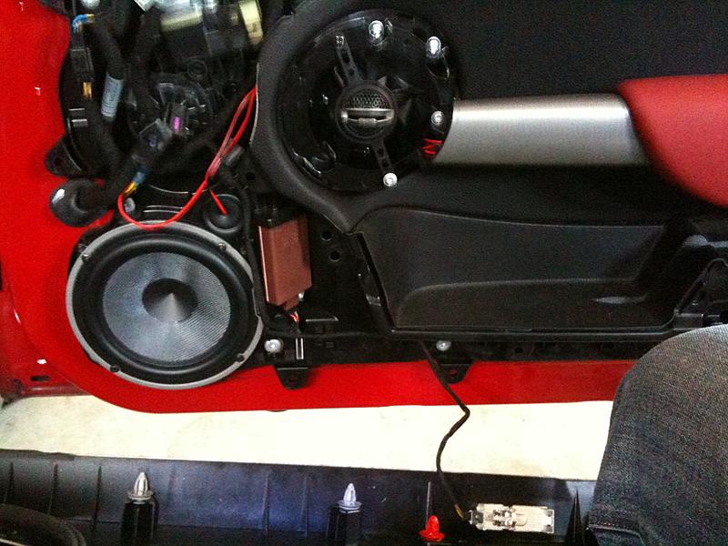

I do have the right side door speakers replaced. I ran out of time unfortunately to get a good connection point for the speaker lead to the crossover. The tweeter is in the upper door location and the 6.5 is in the lower door. I am very impressed with the sound as it is. I think I could definitely make improvements by using the HERTZ crossover. I need to read up on how folks have accessed the channel lead in the door versus the x9331 connector.
For now, the right side sounds great and I have moved the fader more towards the front.
The HERTX 165 6.5" speaker will fit in the OEM hole by mounting it side ways. As you look at the speaker in place, the connectors face towards the rear at horizontal. I carefully drilled and then tightened the speaker screws. There is still what seems like a 2mm gap around the speaker and I didn't want to bend the speaker basket, but it's firmly in place. Another HERTZ speaker owner said he dremmeled the hole for better fit. That's another option.

My one hickup is that I used the speaker lead wires. I have not used the crossovers that come especially setup up for the HERTZ 165 speakers. (have been carefull not to run them at loud volume and have since installed the crossovers for a major improvement!)
To do so would most likely mean wires running from the x9331 to the doors to the cross overs and then from the cross overs to each speaker. The connection for an amp is at that same x9331. I keep thinking, If I am going to the trouble of exposing that molex connector x9331; I might as well get the wires in for the amp.
But, time is my limiting factor. I don't have a lot of extra time and I don't want to give someone else my project. So I might afterall, just replace the speakers without using the crossovers until I can get more time to install the amp.
Sorry so long, but I am really torn about this. I'll say this...the door is not as hard to remove and reading the R56 thread gives insight on what to look out for.
The other thing that is still bugging me is that I think I installed the tweeter out of phase (switched the positive and negative wires). The wires that were right there at the upper speaker position were blue/black and blue/brown. I used blue/brown as the + and blue/black as the - wires to the HERTZ tweeters. The sound is improved and I don't notice any hissing or unpleasantness. But that could very well be the fact that the HeadUnit on the MINI doesn't push them that much? Don't know. Most of the R56 thread talks about wire colors for the hardtop MINIs. Can't find a post where somebody verified the R57 2009 MINI speaker wire colors.

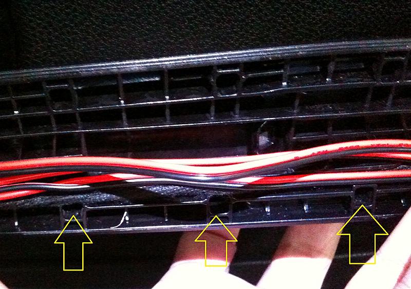

Parallel speaker wire connection point for Crossovers in doors.
Too late, but I found the place where MINI put the wires for the upper and lower door speakers in parallel connection. It was in front of me the whole time but since I hadn't read anything about this, I left it alone at first go. Now I know what to look for when I do the left driver door. If you have a component set of speakers with crossovers, and you are NOT going to install an amp (YET), this is the place to connect for speaker leads (for the NON-HIFI or basic audio MINIs {especially the R57}). I haven't seen this (or missed it) posted elsewhere. You don't have to cut or do anything to the speaker wires that actually go to the factory speakers!

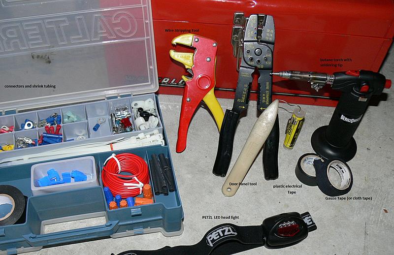

  • An automatic wire stripper (got it at a computer expo)
  • Handy soldering torch (I tried using Cold/Heat but it really was too cold+cumbersome to use)
  • Lots of electrical tape both plastic and the gauze kind.
  • A trusty door panel tool. ($4.95 from Amazon) Excellent to help get the upper speaker cups off and essential to remove the ring around the door handle. I was consistent in breaking off the holding clip closest to the lower pin on both sides. Ce la vie!

1) Wiring location to use speaker leads in the door
2) Center of armrest. The wires in the armrest and note those three box holes, don't let wires cross there as the middle arm rest has bits that fit into there.
There is lots of room in the armrest for these crossovers and you can twist all of your wires underneath. (recommended by electricians when installing sound cables.) I did one door with the wires flat (pictured) and the other door with all of the wires twisted after reading the recommendation on an electronics forum.
3) The driver door setup (you'll notice different color wires)

Tools and Foam Ring picture
FYI - adding pictures of the tools I mentioned above.
Also a picture of the foam ring that I needed to remove from both doors as it was touching the woofer's rubber ring. Might have muffled the bass so I did the removal as a preventive measure. If you have to do this also and the ring doesnt easily peel off do the following. Use an exacto knive and cut the ring to the plastic. Then use the tip of your exacto knife to carefully peel up the ring adhesive tape and then gently pull out and around. Worked like a champ for me.
If there any questions let me know. I already know I want a subwoofer as well, but that is another project for another day. For now, know that these speakers sound great!! I did play with the tweeter adjustment. +2db was too much, so I left them both at 0db.
