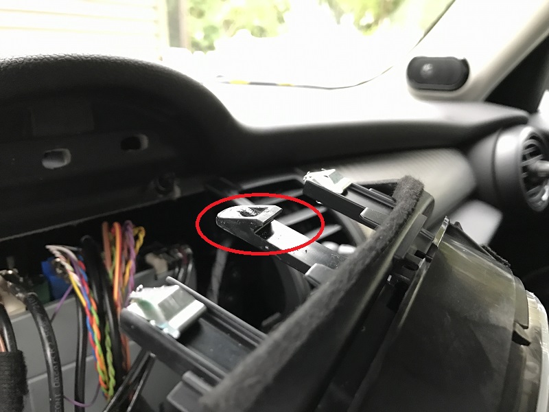

Getting #1 off is a bit of a pain as you need to remove the top vent on the dash and there is a clip that you need to press down on. I have it circled in red, just get a big flat head screwdriver and push down on it, it will take a few tries until you get it. While pushing down at the same time pull out on #1. Before you do that there are two screws towards the bottom of #1, #6 points to the location of one of the screws and the other is on the opposite side.
