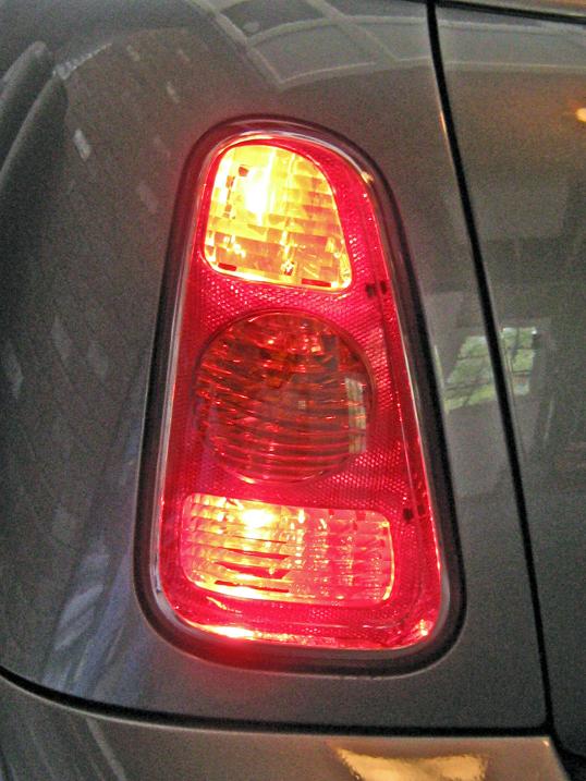

Having been rear ended in two other cars both much larger than my MINI, not sure why I didn't do this sooner......From factory, every 2002-2004 MC and MCS top bulb socket in each brake light housing is dormant with no pw to the bulbs...ready to be activated.
The Cost was $1.49 for two diodes from Radio Shack.....Nice addition to my rear 3rd brake light flasher too.

OK, how did you do it? What did you need the diodes for?

Radio Shack part number 276-1141, from drawer trays in isle. They are black with ONE silver band. $1.49 for the pair. ( Two come in a bubble pack )
The diode acts as a one way switch and prevents power loss and spikes to the bulb extending the life of the bulb. And if you have rear fogs now activated by the dealer, you will have the benefits of both. I bent each end down 90 degrees and used it as a jumper to go from one wire socket to another for each of the two rear light assemblies. Just go in thru side hatch panels, unplug the square sockets and insert the diodes. Just make sure the cathode side goes into the # 1 wire sockets. ( that is the side with the silver band )
That is all there is to it - a piece of cake. Great mod for the buck.
go here to C3 for more detailed instructions: http://www.littlemini.us/technical/brakemod/index.asp

Diodes aren't strictly necessary for this mod, and they will drop the voltage by about 0.6V, but they never hurt.
When you would *really* need the diodes would be if the car had functional rear fog lights. With only a simple wire jumper between the fog lights and the brake lights, not only would applying the brakes turn the fog lights on, but turning the fog lights on would activate the brake lights as well, which you don't want.
Using diodes allows the brake lights to turn on the fog lights without allowing the fog lights to turn on the brake lights.

Right-o, forgot to add that, since some may have already activated their fogs and switch banks.

You need to be careful with this mod as there have been numerous cases of this mod being blamed for a BCM failure. If you want a better alternative you can actually just swap the leads and have the fog light activate for the brake lights and have the lower one for running lights. This way it doesn't subject the BCM to any additional voltage.

The OEM rear fog in mine has no avenue to send voltage anyplace else ? And the diode is a one way switch preventing power backlash.
If you use a paper clip or copper wire, i can see how THAT would be an issue though.

The concern is that rather than the BCM only having to provide enough current to illuminate the brake lights, after the mod it has to provide enough current to illuminate both the brake lights and the fog lights. This is true whether you use a jumper wire or a diode to make the connection.
If you wanted the same result without putting any significant additional load on the BCM, you would have to use relays to power the fog lights from the battery, and use the brake light wiring to activate the relays. The coil in each relay only draws about 1/6th of an amp, so the setup would only draw an additional 1/3 amp from the BCM.
Great...........
Guess it's off to Radio Shack or the auto parts shop for some more parts..........Hopefully it should still end up being a decent mod costing less than 5 bucks though. I'll take pics along the way and have this mod updated.

Another way to make this mod safe is to replace the fog bulbs with LED. They draw little power and would be easily handled by the BCM. However good LED bulbs cost a lot more than $5 each.

The cars I were reffering to DID NOT have the rear fogs activated. Doesn't make much sense to have them activated and try to use them as additional brake lights.
The mod I was reffering to is still the safest one. The lower lights are the running lights and the upper rear fogs are now the brake lights. A little higher and a bit brighter than the dual bulb. And no possible problem with the BCM.

Can someone who has done this check the change with a meter to see what the increase with the diode actually is over OEM?
