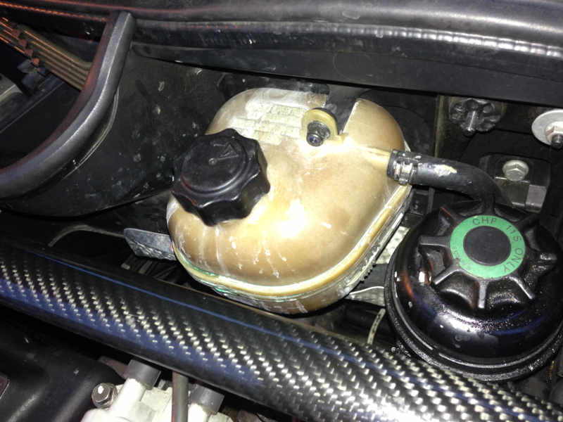

Originally Posted by Capt_bj
who flushed it?
I'm still guessing it was improperly bled
did they know there are 2 coolant bleed points on the top end of the GEN1 S cooling system?
btw - GEN1 S colant res' - ever been replaced? They only last about 4 years then the seam splits and they leak.
this one is leaking from the back side - the side against the firewall. It was the second one I'd put in this car.
Here is my reservoir.. And I had it done at a shop. Yes I would imagine so, as I could see that the points were opened when I first got the car back from him... I could see where they had been taken off

I dunno if it the source of your problem
but IMO those tanks are toasted and need to be replaced.
and THEN the system properly bled

Your replaced tank looks like it's leaking again. Wipe the tank seam down and the whole thing then check it after a heat cycle. Your power steering bracket is missing a M6 nyloc nut/washer too.
Jeremy
Lol that's the stock bottle at 101k... What nut are you talking about?

101K that's pretty good then! Did you replace your heater core then? I'm dreading when I have to do that.
