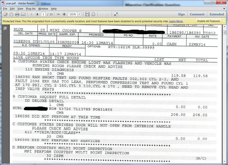

I was able to get the most recent service record from the dealership and their recommendation (please see attached images). In addition to the info contained in the images I have heard/observed the following:

I thought I had found the problem when I started reading about the carbon buildup issues until I realized that the R53 is not direct injected. I have not been able to get the dealer to return my calls regarding their diagnosis as they only mention compression numbers and made no notes about a leak down test on their report yet somehow they seem to have it narrowed down to exhaust valves (see images).

Well, cylinder #3 compression is low...110...but sometimes dealers Skip to the most $$$ solution to be sure they get the issue fixed on the first try....the fact it is saying misfire #2 also..150 PSI means I might look more closely before assuming the worst...I would loo at the plugs, and coil, and wires...lets face it..often overlooked...maybe do my own compression check....
the p2096..could be a cause of effect of the misfire I guess...but would still look around.

With those numbers and 186k on it you almost certainly need a valve job. My wife's '03 Cooper needed one ad a lower mileage (just over 100k) so a fellow club member helped me do it. I would advise getting the $75 chain holder/head removal tool on eBay and have a go at it. We had ours rebuilt for way under $900 but we only needed one valve.
