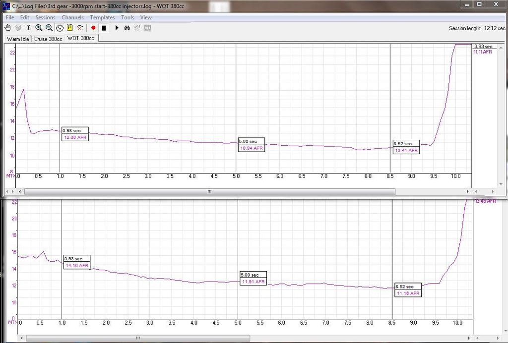

I got the 380cc injectors put in today and logged another WOT run from 3000rpms to 65000rpms in 3rd gear. You can definitely see that the 380cc injectors (top graph) are running richer than the 340cc injectors (bottom graph)....but that was expected. The car feels slower...
I've already got my DME pulled out and ready to ship to Way Motor Works for their Quick Tune flash set up for the 380cc injectors. Hopefully the new tune will lean out the mixture a little bit and get it making some good power again![Thumbs Up](https://www.northamericanmotoring.com/forums/images/smilies/thumb-up.gif)

Running richer isn't always "safer" by any means. Too rich of an AFR can burn out cats and fuel-wash cylinder walls; neither of those is a good thing. 11.5 AFR is a good target for most forced induction cars, even at redline & peak boost. The R53 isn't a unique snowflake like we always want to believe, and requires the same basics that nearly all other port injected, low compression, forced induction cars need. A 10.5 AFR isn't do anything good for anyone. It wastes gas and makes shitty power.
![Need to make a choice on a "canned" tune for 380cc injectors.-forumrunner_20150331_105423.jpg](https://www.northamericanmotoring.com/forums/attachments/r50-r53-hatch-talk-2002-2006/108372d1481854786t-need-to-make-a-choice-on-a-canned-tune-for-380cc-injectors-forumrunner_20150331_105423.jpg)
He's right even with a nitrous set up in addition to everything else, I still aim to keep my tunes around mid 11 afr. Also nitrous will put holes in exhaust if you don't tune right it's less forgiving.
