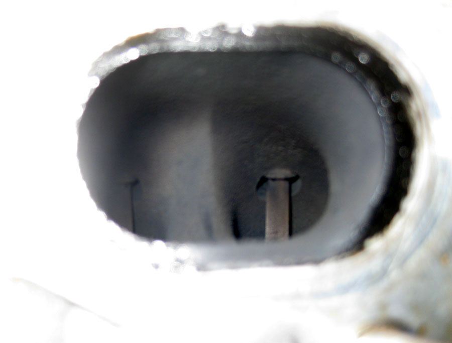

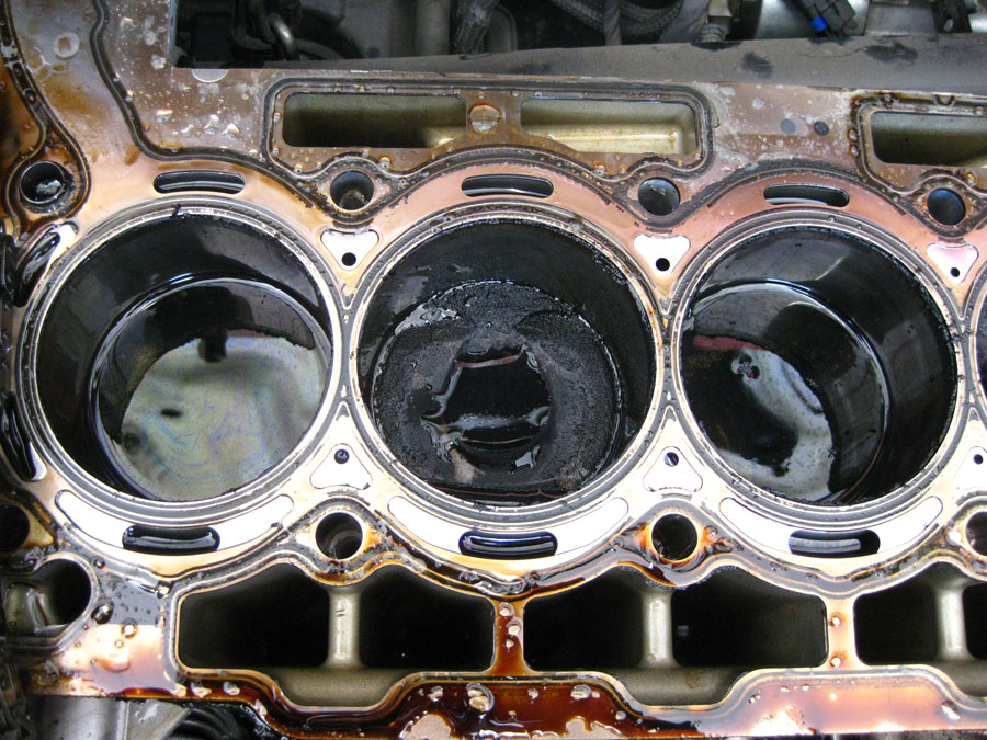

Just got back from the shop- the carbon buildup wasn't as bad as I imagined, but then again, I'm no mechanic and may or may not know my exhaust from a hole in the ground. I shot a few pics of what I thought I should be looking at...

Old 08-15-2013, 01:33 PM
Braminator's Avatar
Braminator
Braminator is offline
Join Date: Aug 2011
Location: Wherever she takes me.
Posts: 7,242
Received 51 Likes on 36 Posts
WOW. Did they pour oil into the cylinders? That seems excessive. The valve guides will let some thru but not like that IMO. I think you have some ring issues as well.
Old 08-15-2013, 01:49 PM
OldPepperwood's Avatar
OldPepperwood
OldPepperwood is offline
Join Date: Oct 2012
Location: Middletown, CA
Posts: 35
Received 0 Likes on 0 Posts
Like I said, not really sure what I was looking at, but my guess is what's in the cylinders is part of the cleaning?? I asked about the rings, he said absolutely no problems with cylinders, etc. The main concern for him was the thickness of the carbon buildup around the valves. Expected from a car with 150k miles, but not 53k- and this is the second time it's been cleaned off!

Received 6 Likes on 6 Posts
That carbon didn't look too bad. It really gets built up on the back of the valves, just below where your picture couldn't see.

Received 19 Likes on 19 Posts
Had a groupbuy for walnut shell blasting in El Monte, CA at my friend's shop, LTMW for a long time but no one jumped on it. Your buildup was nothing compared to mine though.
