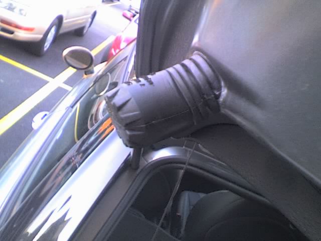

1. the rubber tube at the top of my hatch is too short and keeps popping out of the hole. inside this tube are wires. the only thing stopping water from getting to the wire and in the hatch hole in the rain is this rubber tube. why would it be too short, seems weird to me. anyway that keeps popping complelety out. if water does get in the hatch does it just drain out like the doors or would that be a possible problem (rust ect.).

also my bigger concern is the tub that keeps popping out of the top (image shown). it keep popping complelety out of that hole exposing the whole inside.

The flexible boot covering your wiring looks to be installed incorrectly. Do you see how at the other end there is a bell at the end that meets the metal and completely covers the hole. On your problem end that bell looks to be shoved completely into the hole.
Show it to your dealer, or if you have the nerve you can try to carefully pull it out, don't tear it, and then try to seat it properly. It shouldn't be hard, but don't do it if you are not comfortable with it. Thats what your warrantee is for.
