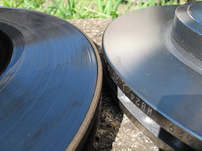

The '07S front rotors were at 20.5mm after three years and 29000 mi and the dealer would not replace the rotors under the maintenance program before it ended because front rotor service limit is 20.4mm. The OEM Jurid pads as most of you know are very messy, some of the worst pads I have seen. BMW and Mini should dump these pads as OEM. Sourced Wagner rotors and Akebono pads for the replacement parts and read several pad replacement posts on NAM to get some pointers. Thanks to all who wrote about the job at hand, I would rather learn from others than to make the same mistakes again.

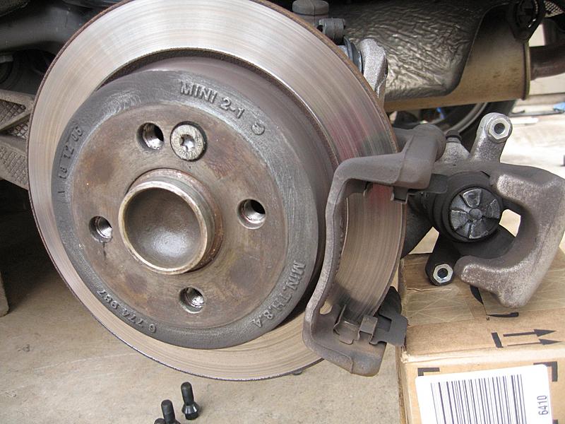

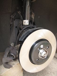

Remove tires, remove caliper, remove caliper bracket, remove rotor, clean caliper, put pads in clean caliper, clean wheel hub, install rotor, compress new pads into calipers, replace calipers, bleed brakes, bed brakes.

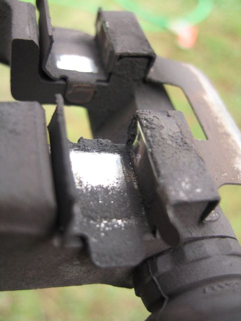

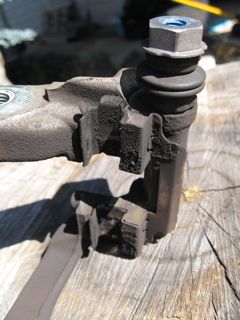

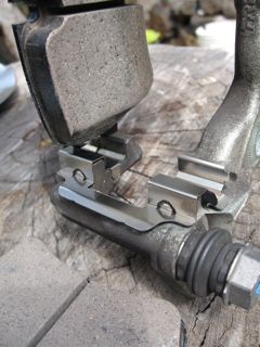

The torx screw was no problem, used a big wooden block and a lug bolt installed to keep the rotor from spinning as you crank on the torx to loosen. The calipers are simple to remove, you need a "thin" wrench to hold the lock nut on the caliper while you loosen the 13mm outer bolt. Very dirty so a lot of time is spent cleaning the caliper of old dust/pad material. Take your time and clean the pad guides/channels on the caliper, that contact point of the pads affects the overall operation greatly. You can take the stainless steel brake pad guide out of the caliper bracket and clean it easier, be careful not to force it or bend it. Dab a bit of the supplied brake lubricant on the tips of the pads and its channel that it slides on during operation. Open the brake bleeder screw and put a piece of clear tubing to let the brake fluid out as you compress the thicker new pads so they fit around the new rotor.

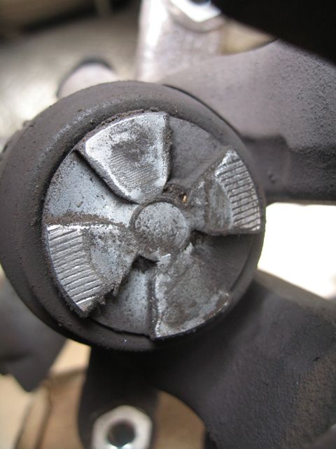

When you do the rear pad replacement you will see a caliper piston that has a X pattern on it. I was not able to compress this piston without turning it as described in other posts. I took my 24mm open end wrench put on a pair of vise grips for leverage and pushed and turned the piston to get it to retract. This was the trickiest part of the whole job. Lock the ends of the wrench in the X and turn clockwise and push slowly, steadily and hard.

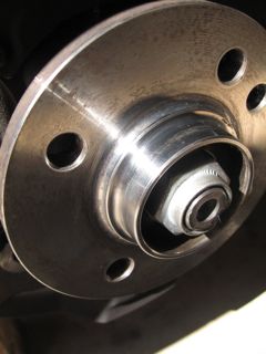

pics; supporting the caliper on disassembly, Jurid coated caliper bracket, cleaned bracket with Akebono pads
