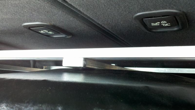

I manufactured a rear brace similar to the M7 rear chassis brace with a middle upright spar for a spare tire mount. I don't think mine is functional as a chassis brace but it hods the spare perfectly as I had intended and looks pretty cool too. I drilled and installed a stud in the center of the upright for the tire mount, made a cone to center the spare rim. I then whipped out a naugahyde wheel cover with a zipper on the sewing machine. The cover looks great from a distance but up close you can tell It is done by hand. I used a spare from a Suzuki Aerio which is a 16 inch wheel. This spare fits perfect on the rear but needs a 1/4 inch wheel spacer for the front as it will contact the caliper in parts of the rotation otherwise. The wheel fits almost perfect under the rear cargo cover but as the cover sits on the seats it also sits on the top of the spare.
If I had more money I would have purchased a M7 rear chassis brace, installed a center upright with a stud. This would have saved me lots of time. I also would have purchased a spare intended for the mini and a nicer cover. I hope this procedure helps. I love how it ended up but miss having the cargo area. At least I have my rear seats available.
Justin

Wow- nice work!

Very nicely done. I'm considering switching out my original wooden box I fabricated for something similar to yours. I have no use for rear seat, and completely removed it - so, slightly different mod.
BTW, I've always been told never put spare tire on Fronts of FWD vehicles. If must drive, switch the rear to front.
Again, thanks for the Post & photo's.
