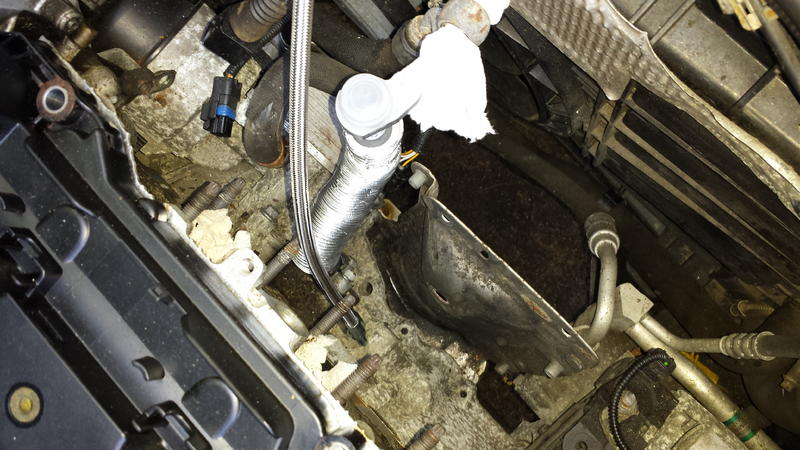

Then in april i decided to fix things up a bit. Ordered new wheels, sent out the turbo to get rebuilt and have a larger housing and larger compressor wheel installed. Ordered a riss dp and CNT exhaust to get rid of the old loud one (OBX catless dp w 2nd cat delete and jcw rear section)
