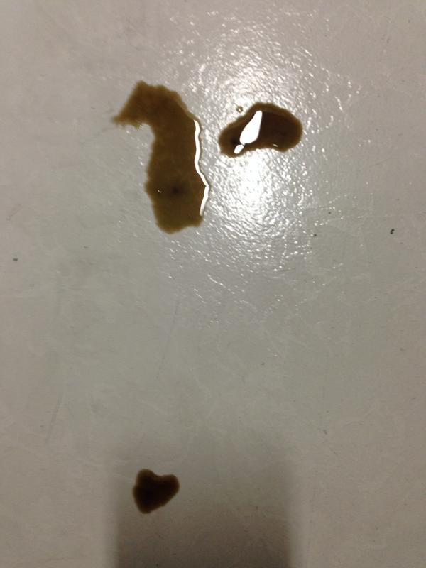

Hellow Everybody
I am new on this, I just bought My MINI 64K Miles
My R56 MCS 2007 i leaving an #Oil #sport and i dont know what is the cause
I am atachin some pictures
Some one can help me to identify the probably cause.

Pictures of oil on the floor tell us nothing.

I agree it's kind of hard to tell from the pics, but the easiest thing to check for is the oil drain plug. It's underneath on the passenger side of the car and can be seen from the front of the car. Maybe whoever did the oil change last did not install a crush washer or did not torque the drain plug down to correct spec.

Even a pic of the underside of the car....preferably on jack stands can help a bit....
At the the very least....check you oil... Or your "#oil #sport" might result in an engine failure....

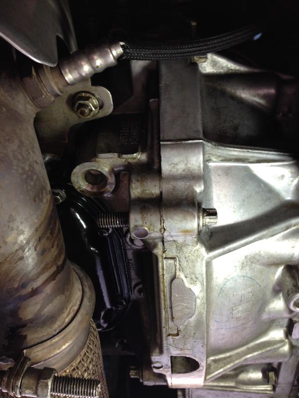

Hellow Everybody, New Pictures
I beleive the is two oil leaks on diferent places
Tks

Based on being a 2007, it is likely that the gaskets between the oil filter housing and block are leaking. There is significant staining in the pictures, which tells me it has been leaking for a while.
I agree that he should check the oil filter (just replace it with new and a new o-ring), and clean as much of the block with brake cleaner. Then look for a fresh leak after a day or two.
