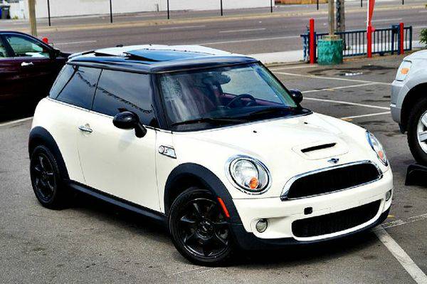

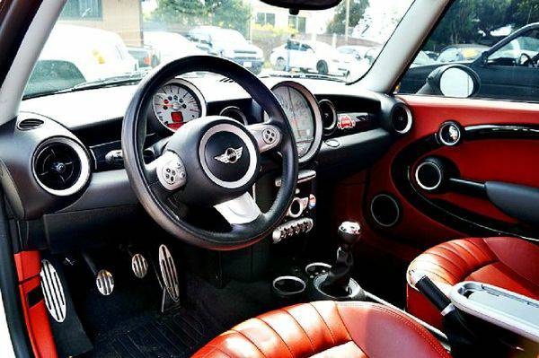

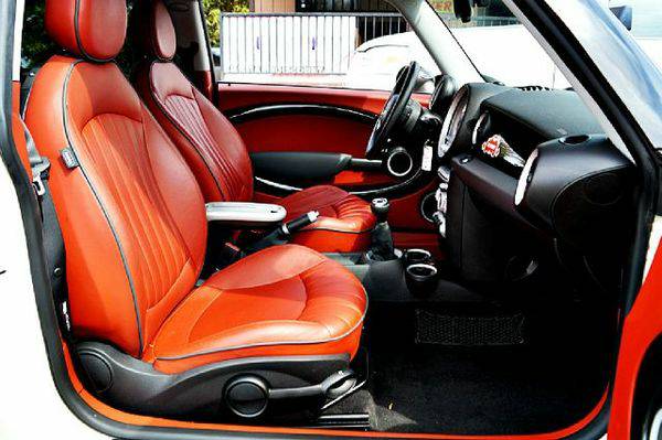

Hi,
I'm looking at buying a 2007 MCS. It's got a great color combo (Pepper White/Red Interior) and low miles at 62,000.
It's my first...anything I should look out for? It's got a clean carfax and 3 previous owners. It's missing a couple of minor things (cover for tow hook, antenna nub) but looks to pretty clean otherwise. They are asking $12,900 for it.
Would love any help or insight anyone can offer. Probably will pull the trigger tomorrow (Thursday) if it looks good.
Thanks!
Michael

The first thing I would do and bargain that price down, its just a tad high. It looks to me like it needs a few things as you stated. I also see the center arm rest cover is missing. Thats roughly $60. Tow hook cover not too much, but you'll need to have it painted to match, so bargain that price as well.
Get the VIN number and call a MINI dealership to see if the Timing Chains have been done. As well as the thermostat/housing and water pump. When I bought my '07 last year I checked on the Timing chains, but not the water pump and thermostat/housing. 2 months later I had to replace both and I had 57k on my MINI at the time. Also check to see if there is any active recalls. Sometimes (if you're not dealing directly with a MINI dealer) you can bargain down price on the fact you have to travel to a MINI dealer for recalls. But that can be hard to do.
I also had a Fog light that was delaminated so I bargained that down too. Check for ANY imperfections, because they have that car priced high.

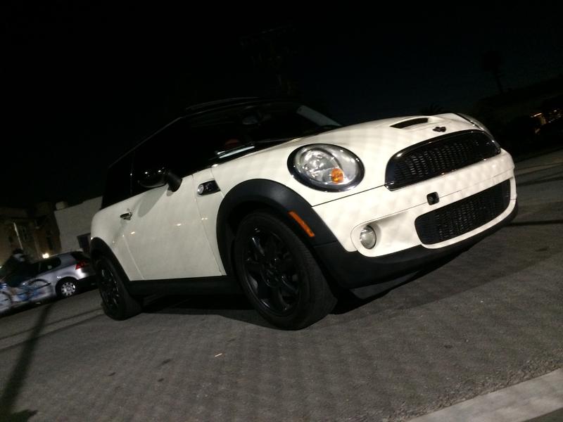

Here are some pics!
https://www.northamericanmotoring.co...mini-home.html
