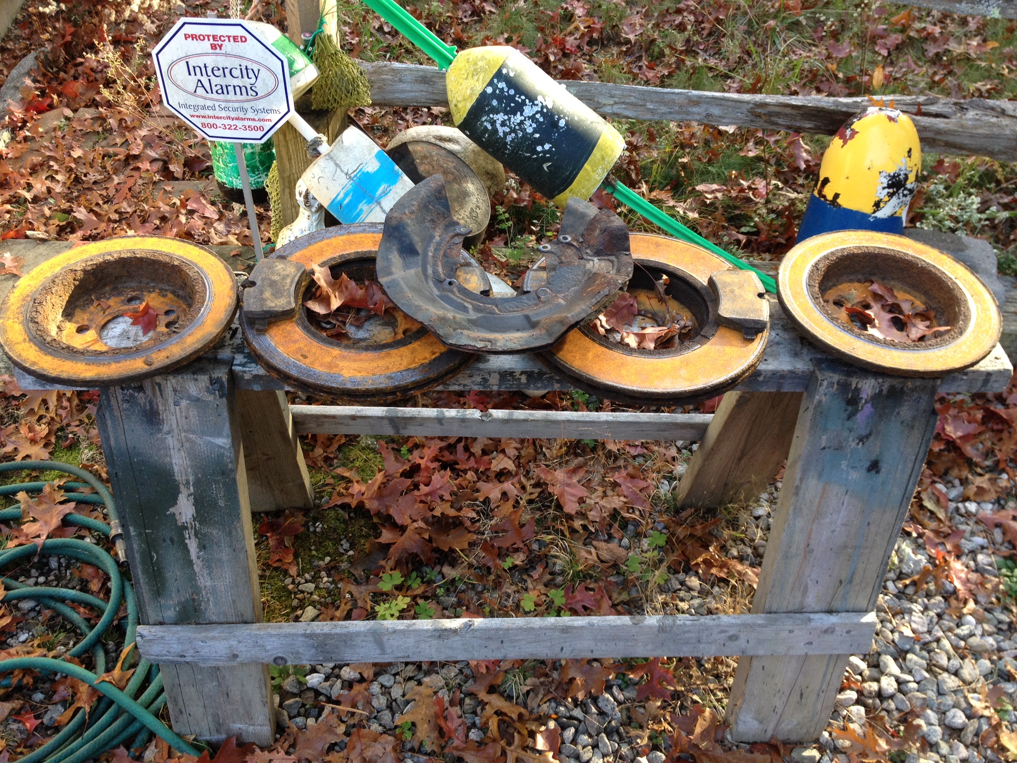

Just got done drilling the heads off the front tore screws they were frozen, broke one bit then they stripped. Six years ne winters. Was able to get off the mud stone guards that are gone also.
Assuming the rears will be the same if I had known to take those tori out & anti seize.
ZZimmerman front discs rears are a mini mania replacement.
Yeah, rust never sleeps...

Ebc brakes
Got parts from Mini mania price was about the same as Mini
But I got Zimmermann disc's up front & EBC brakes.
The disc holders in the front were okay, the rears were gone.
Evidently EBC does not supply holders because you do not use them if not supplied.
Has any one installed EBC pads these are red

disk holders?
I used EBC reds on my 7 and was quite happy. Had used EBC greens b4 and the reds were a bit less dust ....

Ebc
Originally Posted by Capt_bj
disk holders?
Assume you used them with or without the pad retainer mini's come with?
Are you talking about the Retaining Screw that holds the Rotor to the hub, or the Shim/Clips that sit in the Caliper frame with the Brake pads against them ?[ spring clips]
