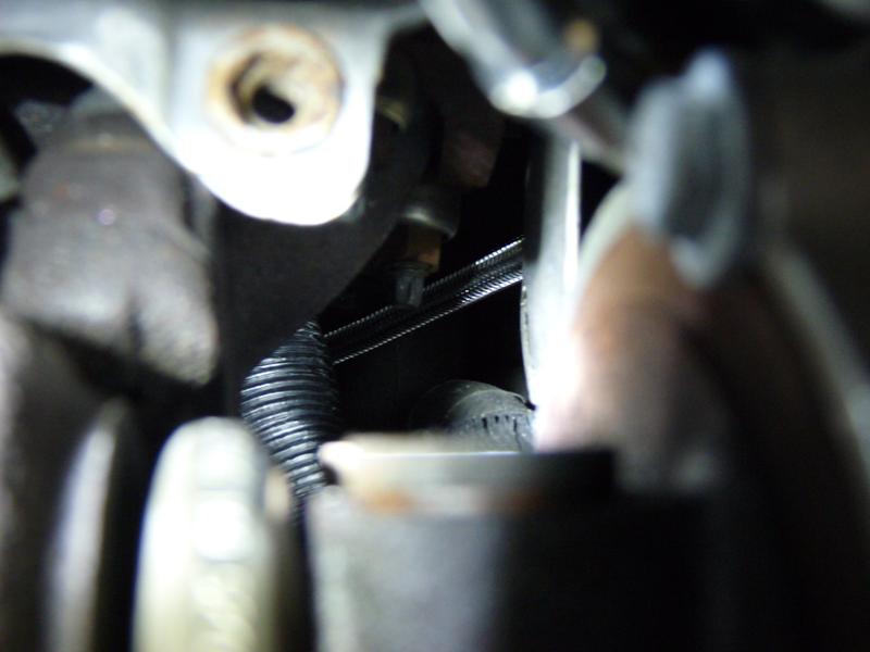

do you know if the line is suppose to go to the right of this small heat shield? the oem one did, to protect it from the exhaust I'm guessing. however to get the DT line to go to the right would require like a 90 degree bend in the line, I don't know if I should try bending it that much. if its not protected by that heatshield I'm afraid the oil could cook.
edit: I got it to the right of that shield but its below the return hose...?

It definitely... DEFINITELY needs to be to the right of that heatshield. The exhaust manifold hear night MELT your line. It's made of plastic under that stainless steel braid, you know.
Try keeping the fittings loose until it's where you want it to be. Detroit Tuned's online installation guide had a helpful picture to show the path.

Take a picture for us? I don't know what you mean exactly.

thanks. I didn't know it was made of plastic. in this picture the line is going under the return hose. the oem line went above it. I think its touching the oil cooler and the bottom of the return hose the way its routed in the photo.
edit: i may be wrong about the oem line going above the return hose. do you know? i think it goes either between the oil cooler and engine or oil cooler and return hose?
edit2: think I figured it out.

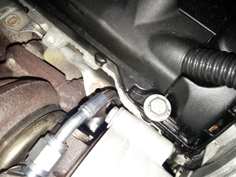

thats good. I finished up today. so far so good. just some smoke from the pb blaster and anti seize probably. were you able to get your line in so it wasn't touching the bottom edge of that exhaust heatshield? mine is touching it and the oil cooler, as well as the engine, I attached a photo of it touching. seems like they could have bent it a lot more.
I was also able to reinstall everything without service mode with no fuss. the top heatshield was a little tricky to get back in place. but removing the oil dipstick tube helped.
My line does not touch the engine block. You can loosen the top fitting, turn it until it doesn't touch, re-tighten. =)
