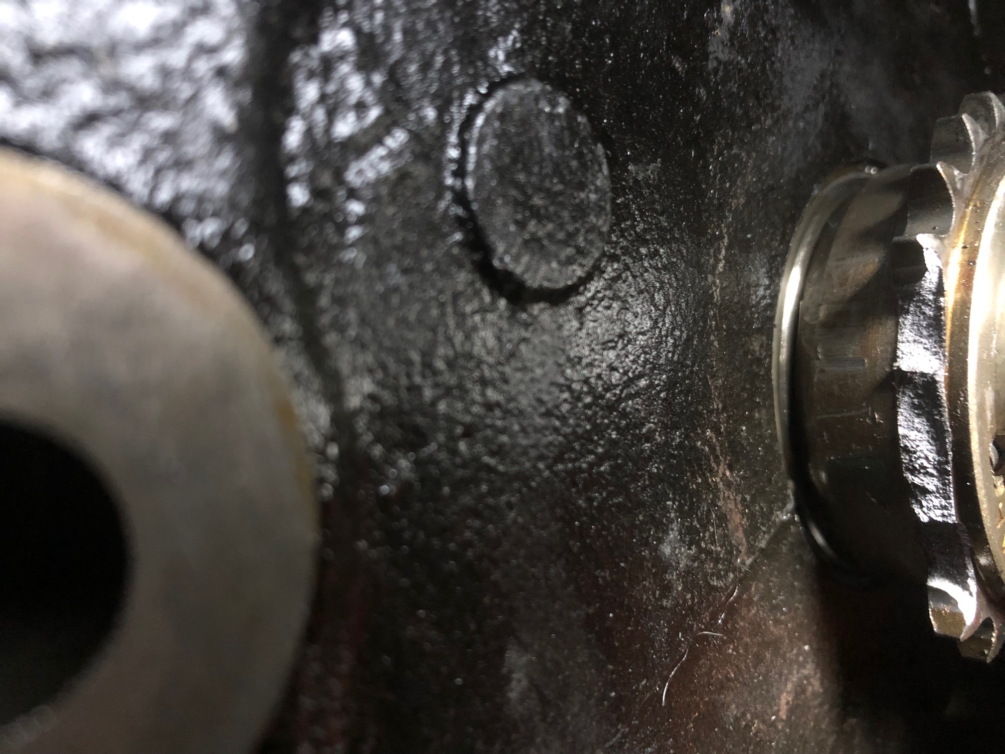

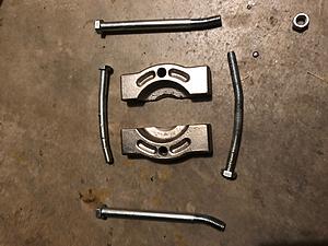

The crank sprocket on my R53 was a bear to remove. I first tried a rental 3 jaw puller from Autozone and heating the sprocket, but the puller jaws would just pop off. So, I ordered a 2-1/8 bearing splitter from Amazon. It was a tight fit, so I had to use slight smaller bolts to angle it into position. Here it is with an rental Autozone timing gear puller and a scrap of chain wrapped around the sprocket to try to get a better purchase on the gear: ![](https://www.northamericanmotoring.com/forums/attachments/stock-problems-issues/187894d1548100096-removing-of-the-crank-sprocket-img_0813.jpg)
I cranked and cranked on the puller, also heating the gear with my propane torch until the teeth began to snap off the gear and the puller bolts bent. The pulley didn't budge:

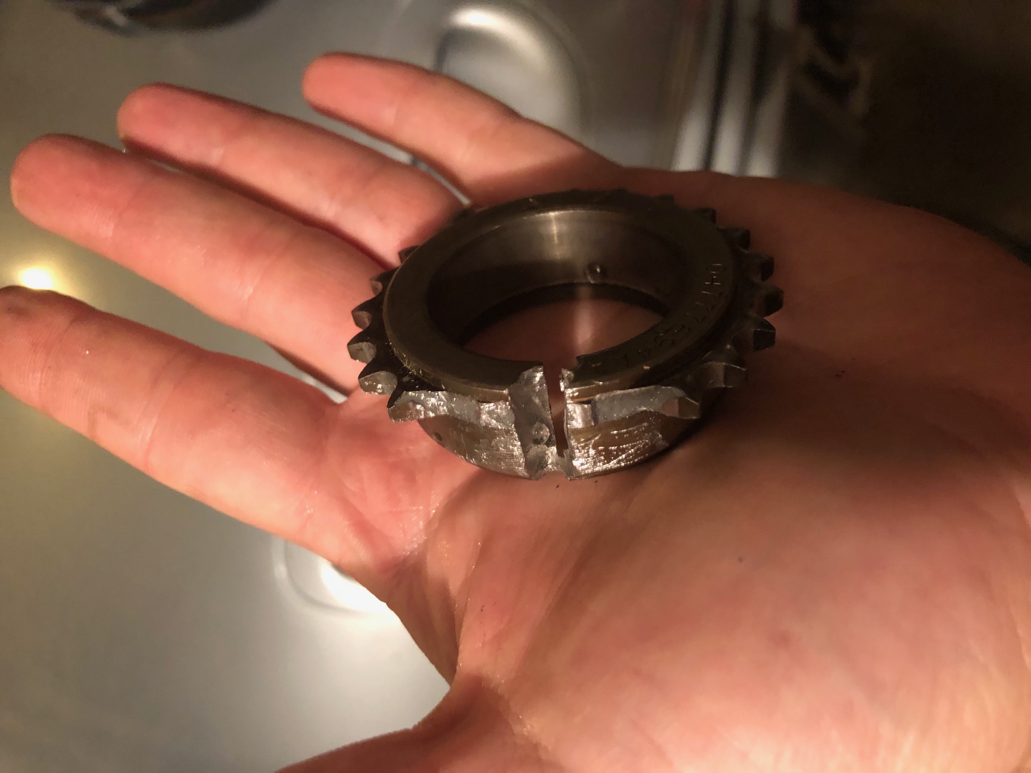

So I used my Dremel with a tungsten carbide bit to grind through the timing gear at the keyway and it popped right off! It took less than 10 minutes and since just ground to the keyway, I didn't nick the crank at all:
![](https://www.northamericanmotoring.com/forums/attachments/stock-problems-issues/187897d1548100096-removing-of-the-crank-sprocket-img_0823.jpg)
I put some strong rare earth magnets near while I was grinding to catch the filings. The magnets caught a lot, but they still went everywhere and stuck to the oily face of the block. I hosed the face of the block off with brake cleaner, so I could clean the filings out of the oil pan with the other oil pump and timing chain guide debris. One bad surprise is that the filings were like microscopic metal splinters and dug into the skin in my hands like fiberglass. I really wish I was wearing gloves when I was Dremeling and swept the floor as soon as I was done!
Hopefully this will help the next person who is staring down a stubborn crank sprocket!
