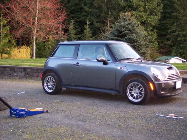

Okay, here's a photo of my monster's 15x8 6ULs (225/45-15 Hankooks) on my MCS. I put them on one side to see what they would look like. I really like the look of the wheel, but the wheel gap is comical. Note that the suspension would probably settle a bit more on its own, and with a lowered suspension this combo would look awesome (in my view).
