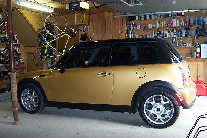

I put Goodyear Eagles in 205/50 on Quentin.
They don't look much if any different from stock to me (apart from the tread pattern). I went for the tires, not the look.

Oh cool, exactly what I was looking for. To me, I can see a slight difference in the sidewall height. Thanks for the visual!

The difference is in theory 9.5mm (less than 1/2"). They're 1.5% smaller than stock so the speedo gets a bit more optimistic.
