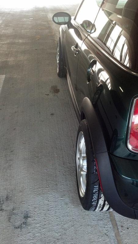

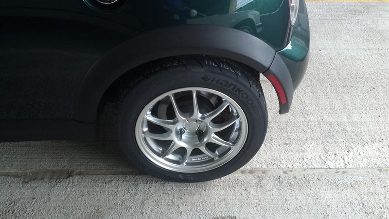

got mine via Alex, thanks!
15x8 ET 35 Enkei PF01 with 225/45/15 Hankook RS-3 (finally back in stock!)
20mm spacers Front (to clear the dyanpro)
5mm spacers Rear (to clear the trailing arm)

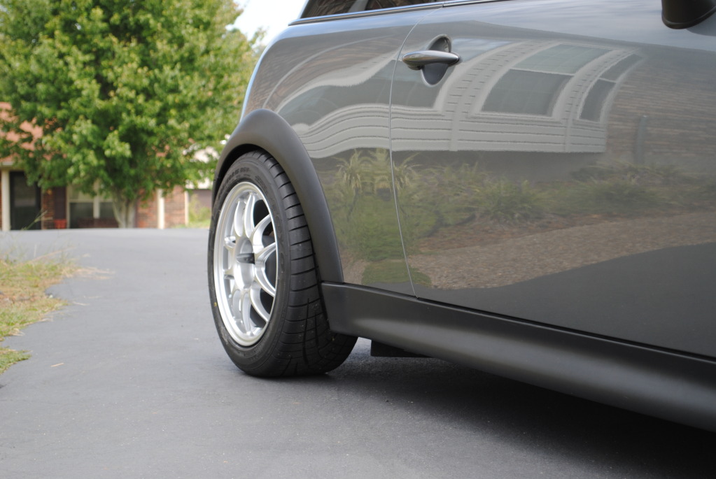

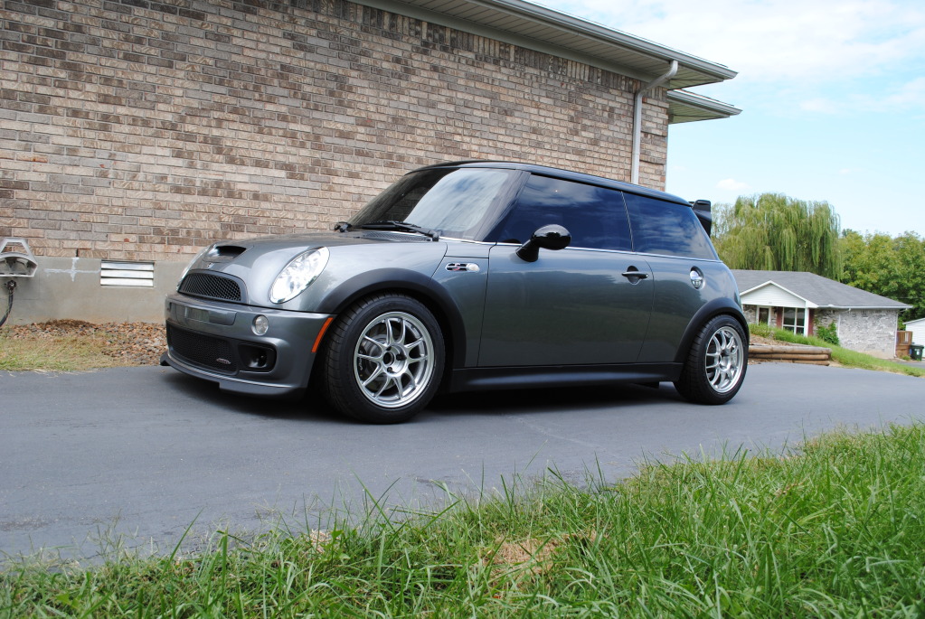

15x8

The Professor's car looks perfect. The stance, color, and size are spot on.

Professor, would you please quote your tire size in the pics and how much your car is lowered... love the pictures!
Thinking about moving to 15x8's (215 or 225 would be preferred) with stock sport suspension on a 2007 MCS -minihune or Alex, any thoughts on the best tire size for 15x8's or 15x7's with my suspension?
