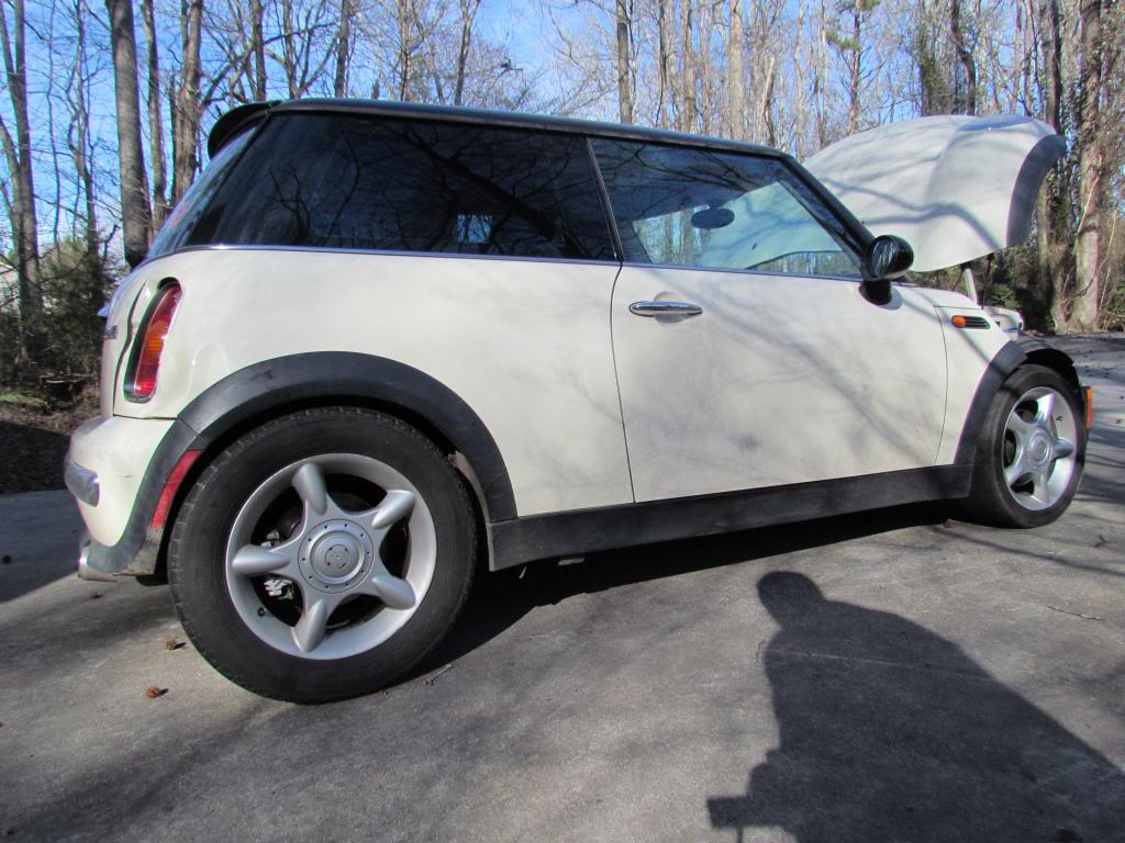

Will order the 205s tonight . Funny thing is the car has 225/55 on the rear now and they look huge and no way they would fit on the front.

Sounds like the prior owner just picked up some used tires, tossed them on the rear, and the rears on the front.....
An owner doing this type of thing does not bode well for other preventitve mx having been done...so you might want dig deeper and look at some basics like radiator servicing, transmission oil, etc.
225/55-16 are way too large for the MINI. They do fit rims 6-8" wide but tire diameter is 25.7" vs OEM 24.3".
205/55-16 fits rims 5.5-7.5" wide, perfect for 6.5" rim so that is the tire with best fit.
225/50-16 fits rims 6-8" wide, perfect for 7" rim, it will fit but is heavier by about 2-3 lbs for a given tire in this size vs 205/55.
