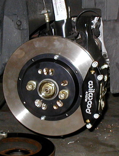

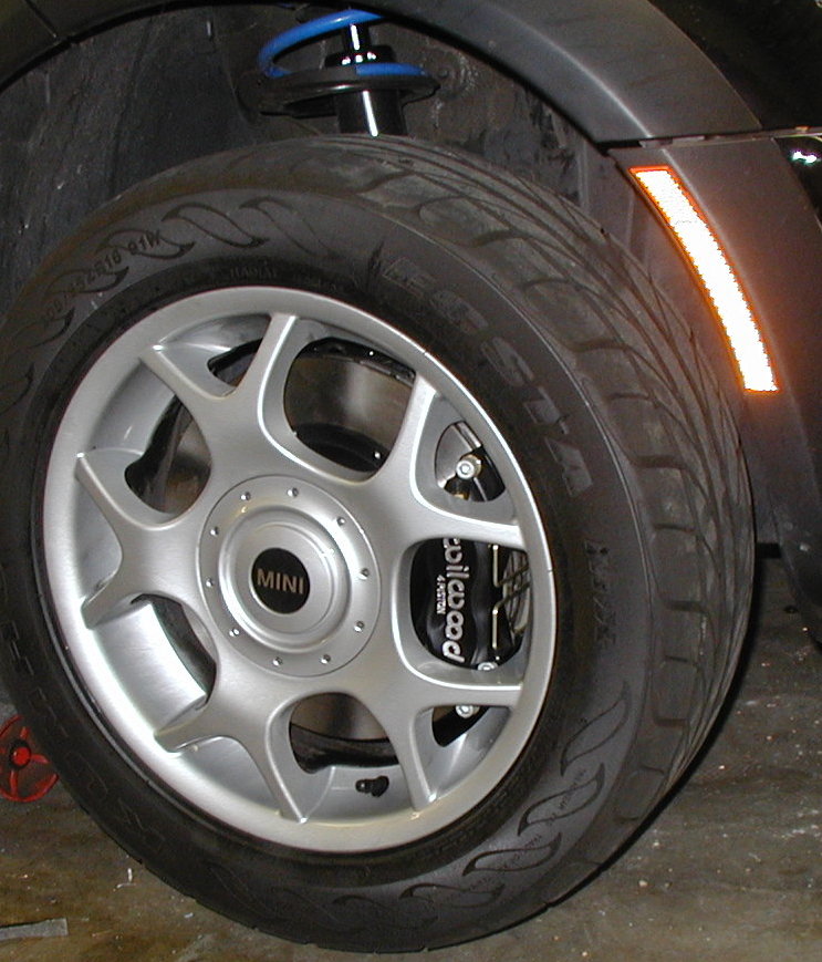

I've worked at length to come up with some alternatives to the current wheel fit problem. The latest, the 12.2 DP set up has proven to fit and clear the 16s of the S as hoped. I hope to test them in some other wheels as I have donors to allow me!
Currently the prototype package is sitting in the shop as the test car was a bit short on funds to finalize the deal. Still, aside from not having the bracket anodized yet this one's done and looking for a home and is in COMPLETE form. I have more of the TCE radial brackets in the works for inventory in anticipation of a rousing success of the package.
While a bit more $ than the larger TCE pacakge, this is due to the choice of caliper and mounting style. The FULLY BOOTED DynaPro calipers are simply more costly. But we don't offer any $250 sets of pads either....yes, pad choice is a bit more limited than the larger kits but we still have affordable options.
All that being said, how about this; complete kit above, with rotor finish of your choice, shipped (gups) for $1000. That's over $300 off, free holes or slots, etc. It's a ONE OFF DEAL. The prototype only, when it's gone, that's it, back to $1269. I had hoped to put this on a local car here in Phoenix but there's been no input from anyone so it's open to everyone. In return I want some feedback and pics etc. to share with everyone.
Minihune and Todd are completely correct.
The TCE 12.2 Dynapro kit is much more effective in many ways to a 13in kit. I had stock 11.9in rotors on my SVT focus and many people said those were overkill for a 2700lb car. They worked exceptionally for me and you can search the Autox/RoadRacing section of Focaljet to see how many owners pound them at the track and have no worries. Many companies are offering 13in huge brake kits for extreme prices, but as they may look nice they are more than overkill even for people who track their cars a few times a year.
Remember also the TCE kit DOES NOT NEED SPACERS. Having to upgrade to 17in wheels for most big brake kits is an even bigger expense, especially if you then push to get lightweight 17's compared to 16in wheels.
