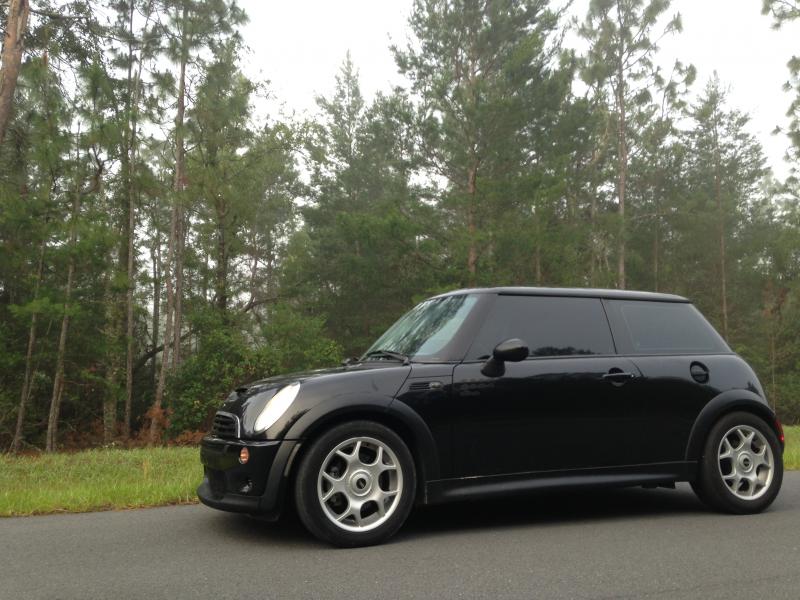

besides that.. here are a few photos of the go kart =]

your reply is grand, I can honestly state that those 17's look great but honestly those 17's you have pictured are the only ones i'd risk the peace of mind for.. good roads or not I would be looking insanely for them at all times..
im going to stick with 16's as they are the nice middle ground but the car you have in the photo.. how dropped is that? I've used H&R springs on everything I've owned and have enjoyed the ride but that looks way too low
