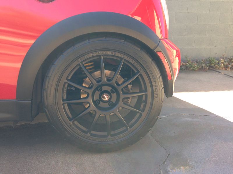

Got my new 17x17.5 Team Dynamics Pro Race 1.2 wheels outfitted with some BFG Rival tires in 215/45-17 size. For those not aware, these are BFG's newest Extreme Summer tires, and have been rated pretty highly -- check out the reviews on TireRack.
Anyway, a few comments:
1) Performance is pretty sweet. I had a set of Riken Raptors (215/35-18) before this, which are High Performance summer tires. The BFGs blow those away in terms of grip... I can take those freeway on/off-ramps at pretty ridiculous speeds now.
2) One thing I found interesting -- these are not unidirectional tires, but rather have a designated inside/outside sides (i.e. to keep the big solid blocks on the outside to improve handling). Anyway, this means they can be rotated L/R in addition to F/B...
Anyway, I really like the tires and new rims. We'll have to see how long the Rivals last, but I don't expect to get more than 1-1.5 years max, as the tread depth is pretty shallow. FYI I'm running these at -1.9/-1.3 camber F/B, which is pretty close to what I had my old ones at as well.
Here's some pics.. Sorry for the washed out colors... a little too sunny here in SoCal recently.

One other comment -- a while back, I posted asking about 17x8 wheels... after some comments (thanks Minihune and others), I decided to go with the 7.5 inch wide TD PR 1.2s.
With the combo of ST coilovers + 215 series tires, fitment is really tight. I had to use 5 mm spacers on the front to clear the suspension (I'm running 17x7.5 et45). The rear only has a few mm of clearance on the inside liner, and I've had minor rubbing on the inside of the plastic trim on big bumps... seems to have worked it's way through now, though.
Anyway, I can verify fitting >7.5 inch + 215 series tires can be tough on R53s...

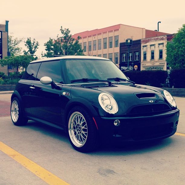

Attached is how it sits right now. It's a little higher in the back, as I dumped the suitcase exhaust...
You're probably a little bit lower than I'll go since it's technically the wife's car and she tends to tailgate and not take as much care as I do when driving. I plan on putting them on at their highest level to see how it looks, then evaluate.
