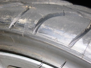

I recently bought some SSR GT1's from Tire Rack. I ended up getting 18x7.5s and outfitted them with the reccommended 235/35-18.
I came out to my car today and found my Rear Fendor arch was completely gone. As I started looking closer, I realized it appears the rear tires are rubbing. My car is completely stock so I was surprised to have any problems.
Any one had similair experiences?

235/35-18? That's at least one size too wide It also doesn't matter that your car is otherwise stock...
Tire rubbing is NOT a function of ride height, but wheel offset, tire size, and camber setting!

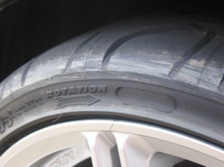

is the first picture on the driver or passenger side????
if its on the driver side, even your tire rotation direction isnt right!

First Picture was on the Passenger side. The rotation is definitely correct.

I just visited tire rack and when I selected a SSR wheel 18x7.5 for a MINI, and then put them in my cart to select tires, the site suggested 215's, not 235's
Best thing to do is to call Alex@tirerack since he is our sponsor and tire/wheel advisor here.

dang 235's on a MINI..should look pretty good though if it was lowered, tucked inside the wheel well using control arms (lots of neg camber). :smile:

1) I mistyped my tire size.. Is actully 215 NOT 235
2) After talking with Tire Rack went by a local performance shop to have them expect the tires for what the rub was.
Their opinion is that there has actually been a measurement change in the rear for the 05's. They had another 05 in the shop a couple of weeks ago and noticed you could adjust camber now. So what is happening is that when the suspension compresses, the tire rubs against the front of the Fendor, around the 2 o'clock position. So looks like I'll need to get something slimmer.

Front of the fender at 2 o'clock.... from the passenger side? I thought
it hits at the rear top area about 2 o clock if looked at from the driver's
side.
anyway, why not just get the camber adjusted since you have
adjustability? I'd trim the fender a little bit but go -1.8 or -2 on
the rear for street. :smile: will look very good (imo).

Alex will caution you that almost any 215 tire on a MINI could rub in the back, so this has nothing to do with the SSR wheel.
I am very surprised, though, that you're getting enough rubbing to A: see it on the tire, and B: have it rip parts off the car. My 215/50R16 Avons rub when the suspension loads up, and we have a guy in our club who just got 215/35R18's, and another with 215/40R17's. None of us can see any evidence of damage, either to our tires or to the insides of the wheel-wells. We've looked extensively.
In fact, the guy with the 18's is driving an '05. I think you might be looking at a fairly unique situation here. It could be that your camber is 0, or maybe even a little positive. That would certainly cause some more damage during the rubs. But honestly, you should only be getting the rubs when accelerating very hard with someone in the back seat or when hitting big dips.
Of course, if you really don't want to keep those wheels, I'd be more than willing to make you an offer.

What offset are the wheels?
From the 3rd pic, it seems that the wheels stick too far out. I dont know..maybe because of the angle.
I have 18x7.5 offset +40 and I had the same wheel size with offset +42 and had (still having) only a tiny little bit of rubbing problem. Only happens when the car is under full load (4 passengers)
so, it's best to check your offset. I think the best offset for mini is +42

The best offset is the one that doesn't rub.
For a stock suspension MINI the offset range is about +37mm to +48mm in general. This assumes wheel width up to about 7 or 7.5"
Once you lower your MINI you have less room. The range shrinks to about +42mm to +48 with +45mm being relatively safe for rims up to 7.5" and in 16 to 18" diameter.
I have 17x7 rims with offset +42mm and do rub (under load and on corners) with H-sport springs.
